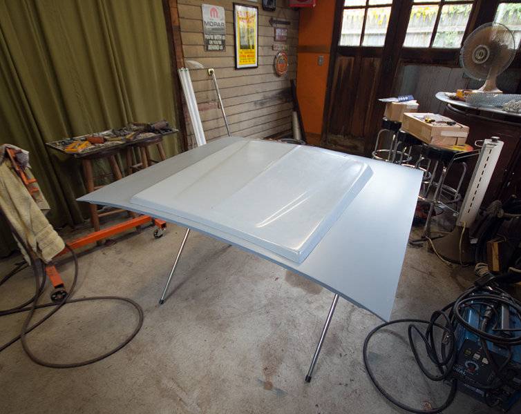

I have both in stock. I am the only one offering the Lowboy. The scoop pictured above is what I believe to be my Low boy R-O scoopMike

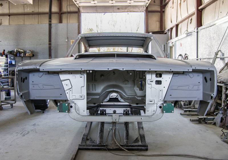

I always appreciate seeing my scoops in the build up pictures
