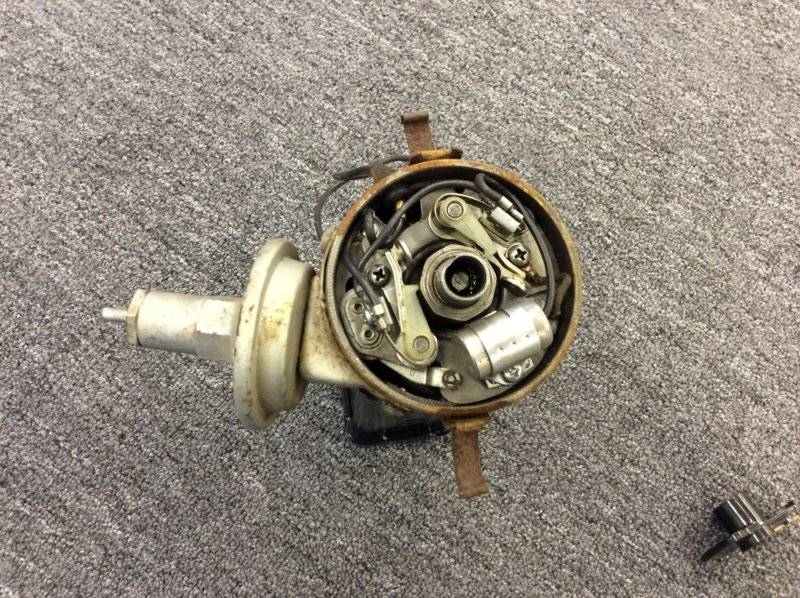

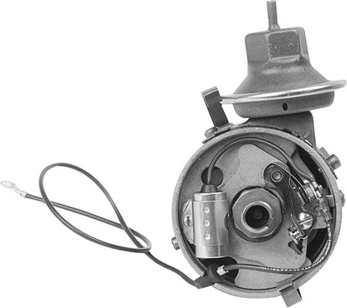

Small block and big block distributor. Which one do you have?
That might be a little confusing as those are points not electric and over the years the vac adv pods look different.
View attachment 1000652 View attachment 1000653
I have the one on the right. If it was a small block, I believe the rotation is clockwise, while I know big block is counter clockwise. I should have never gotten the engine to fire with the plug wires in position for the counter clockwise rotation on a clockwise distributor.
Yep!
