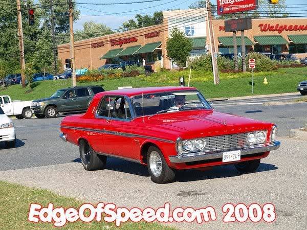

I have a 9 second 65 plymouth & had hoosiers on the car & was a big fan of hoosier 60ft time was 138. And then i found M/T never will go back to hoosier 60ft time dropped to 134.8 And they were both same size
