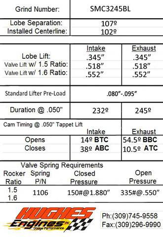

1977 440 new rings and bearings. Heads have been port matched and bowls blended, milled .030 and had a valve job and new seals. Hughes Whiplash cam, lifters & matching valve springs..518/.518 lift 232/245 duration @.050 Melling HVHP oil pump. Edelbrock CH26 dual quad intake. Two 600cfm carbs.

The short block is stock 32,000 mile that has been cleaned ball honed with new moly rings and new bearings. It also has a new timing chain and oil pump. The heads are 452 castings that have been milled .030 and had some port work. They also have had a valve job and new valve seals. The cam is designed for the low compression engines. It’s a Hughes, and has the matching valve springs. It also has headers,,,,,
Original description,,,,1977 440 new rings and bearings. Heads have been port matched and bowls blended, milled .030 and had a valve job and new seals. Hughes Whiplash cam, lifters & matching valve springs..518/.518 lift 232/245 duration @.050 Melling HVHP oil pump. Edelbrock CH26 dual quad intake. Two 600cfm carbs.

I don’t know what the EM 440 used for a cam, but I’d say it’s a pretty safe bet that the OP’s cam would make a bit more power than the 280H I put in the 446-6 referenced above.

I'm a fan of Hughes cams. I have one in my 440, but not the Whiplash because I'm running with 10.5 CR and aluminum heads. My guess for your engine is around 400-425 hp. Only real way to find out is to put the engine on a dyno. I did my break-in, set-up and a few runs to see the HP and torque on a dyno. During the dyno tests they can determine if you have too much carb. I'm not a fan of the 452's. I spent far too much money on mine trying to get them to breath better. The Edelbrock heads are way cheaper. With aluminum heads and increased compression I got 485HP. If you do a dyno test through the rear wheels it'll be 25% less depending on your tranny.
