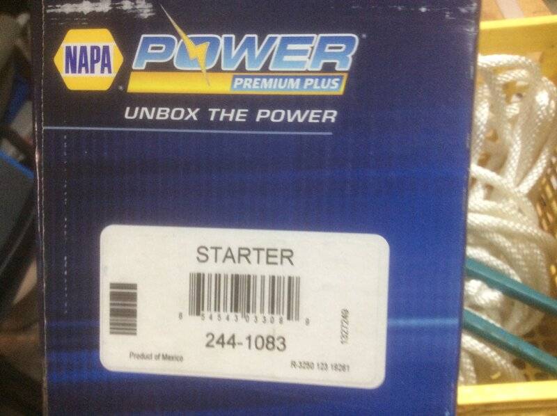

$60 NAPA mini starter remove plastic cover and use posts under it. You'll see, and just to safe check main power stud isn't touching block. That's why you use stud under plastic cover.
