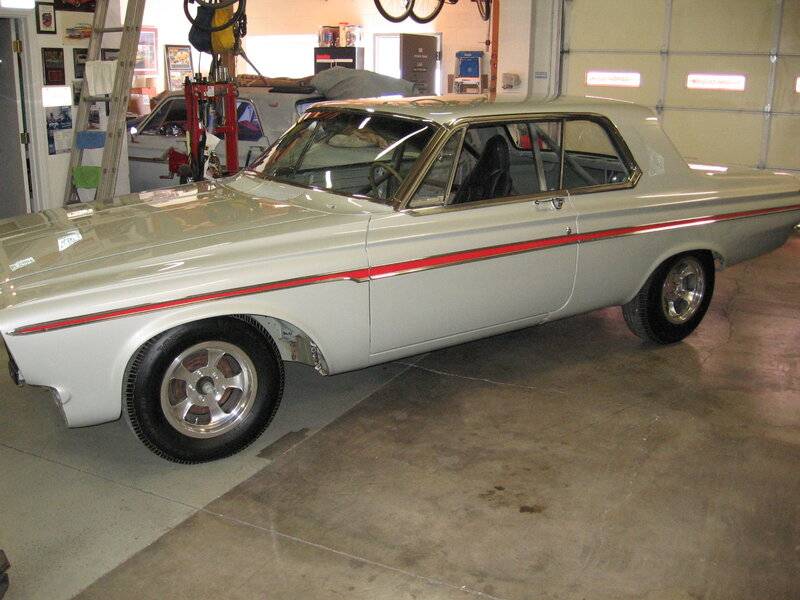

True dat ! That was my plan. 63 Plymouth Belvedere Nostalgia SS/E around 12 seconds flat. Started 15 years ago but my body is giving out. don't think I'll ever finish it.
Not to sidetrack but that is a beauty. I am looking for a 64 Dodge and would be happy with a Poly, 361, or 383. I don't need (or probably wouldn't buy) one with a big wedge or Hemi.

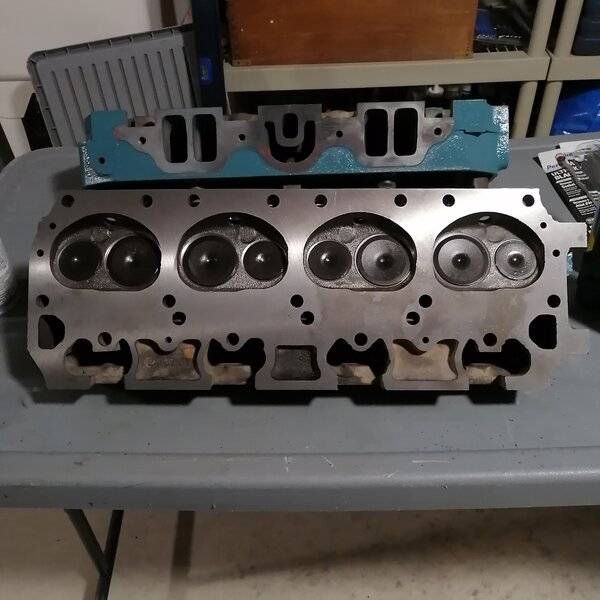

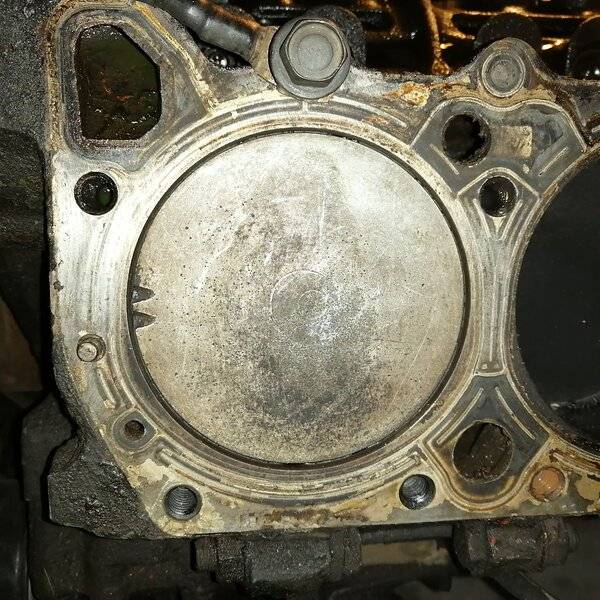

I just redid the top end of my 1966 361. It was originally a 2 barrel engine and the stock pistons were .065 down in the bore. With the 516 closed chamber heads, calculated compression ratio was right at 8.5:1. I believe the earlier 4 bolt valve cover heads were basically the same as the 516's.
View attachment 1190648 View attachment 1190649
There you have it. 8.5 is good. You'll gain a little horsepower with a half point more. (not much though, may be 5-10 horse) Cam selection is important. The wrong cam will bleed off compression and put it into the basement. Only rpm will make up for it. The heads look good but pretty tiny valves. Larger valves and some port work will help but then you are getting into the aluminum head $$ range. (unless you can do the work yourself)
