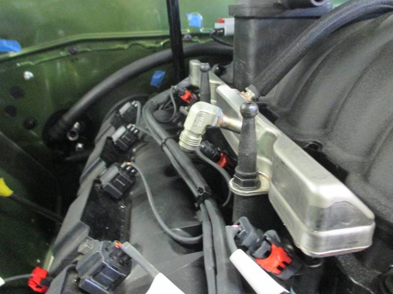

I have to install the aftermarket water-valve into my Gen-III conversion. On a 6.4, which hose is the output, and which is the input? Besides that, does it matter which hose is used to regulate the water in or out of the core? Is stopping the water in either hose, doing the same thing?

It seems like you may want it to circulate even though you bypass the heater core. Use a bypass valve otherwise you may over heat the engine. This is my guess..
Thanks. It sucks that I over-looked the heater control valve. I have to redo a bunch of stuff now. The bypass may actually make things a tiny bit easier for the retro-fit. TINY-bit. I have very little room to work with.
Black hose against cowl.
