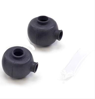

Has anyone that installed the Hotchkis adjustable strut rods used the boots that they offer for covering the Heim Joint? I got a set with my strut rods. I know they are made to be tight around the threads of the Heim Joint and bolt securing it, but I don't think I could stretch them enough to go over the Heim Joint and not rip them while doing so. Has anyone actually installed these?

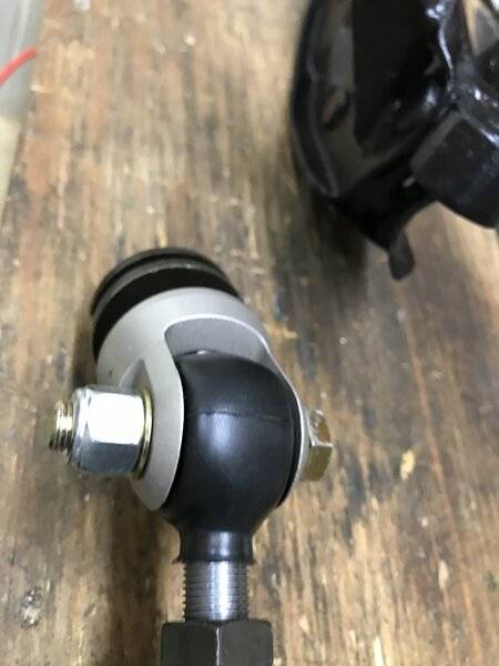

Yes, i installed them without any lube. Put the threaded heim part through one of the holes where the bolt goes and then through the hole for the threaded part, then taped some pliers with duct tape for protection, turned the boot 90 deg on the heim joint and pulled the rubber boot (the side with most rubber.) over the polished heim surface.

I decided to attempt them today since I had some help from my brother. I put the boots out in the sun for a couple hours to let them soften up get nice and hot. Thank you for the idea of getting them hot!
After I let them sit in the sun for a few hours. I did exactly as you said slipped the threaded part through the hole for the bolt and then was able to easily slip them over the heim joint. Thank you also for this suggestion.
It actually was not that hard at all with my brother helping me. In about 15 minutes we had both strut rods apart, boots installed and the strut rods back together.

Hotchkis sells them separate from the strut rods for only $17. I got mine through Summit when I ordered the strut rods.
https://www.summitracing.com/parts/hss-14366-bk
For the couple dollars they cost, and how expensive the strut rods are, I don't know why they don't just include them with the adjustable strut rods.
