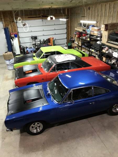

Sems Hot Rod Black. Great stuff. Durable. Doesnt chalk up. Its urethane. Bottom of my race done for 8 years. Still looks like new. Google it.

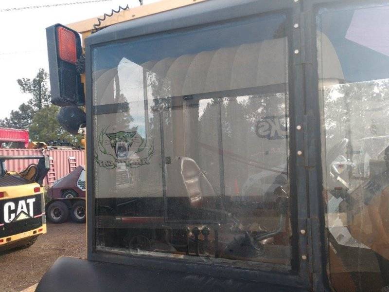

About 12 years ago I fabricated a cab for a John Deere loader. Primed it with 2 coats of SPI black epoxy and asked the owner to use the tractor for a few weeks and if he was happy with the cab, to bring it back for final painting. Well he never brought it back and has used it for over a decade for snow removal in Flagstaff, AZ.
The company and loader were sold a couple of years ago. The new owner sent me some pictures, wanting me to build another cab for his other loader. The epoxy has held up much better than I expected. Actually could just be sanded, recoated and painted.
