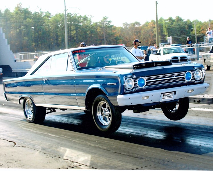

With the outer lip of the 1/4 panel completely removed, springs in stock location, stock inner wheel house and no cutting the front outer 1/4 I run a M/T 28 x 9 ET slick or a 11.50 x 28 M/T ET Street tire.
That fits with no rubbing or interference what so ever.

actionange1, that is a gorgeous ride!!! the previous owner trimmed the outer lip and some of the wheelhouse so I have a little extra clearance. I like the idea of a 28x 11.5 that is a good size. thank you!

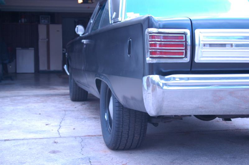

Sure i used a 15 x 7 steel rims front & rear with a 4.5 inch backspacing now with that said i did have to trim the wheel well lip about 1/2 to make sure i had plenty of clearance also i had to let most of the air out of my tires to angle them in to the wheel wells but after i got them in and filled them back up with air i have 1 inch of clearance on the back side and about 1 1/8 or a little more on the wheel well lip.! The tires i used where BFG front & rear.
front tires are 245/60/15 BFG
Rears tires are 275/60/15 BFG
A side note what i mean by wheel well lip is where the wheel well is and it is the part that from the factory has a small lip area that turns back under the car just to let you know.!
I hope this will help out some.! :)

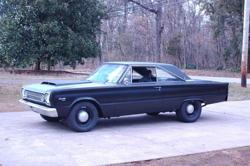

Here is my car with the new tires on it rears are 275/60/15 fronts are 245/60/15

Man that black car looks good with those tires on the back.

Mine don't rub at all period.! And i have went around corners faster than i ever did with my last set up and they have yet to rub.!
