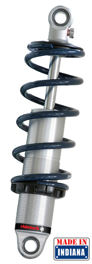

or convert to coil overs

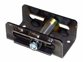

if you stay with leafs add a rear rollers/sliders

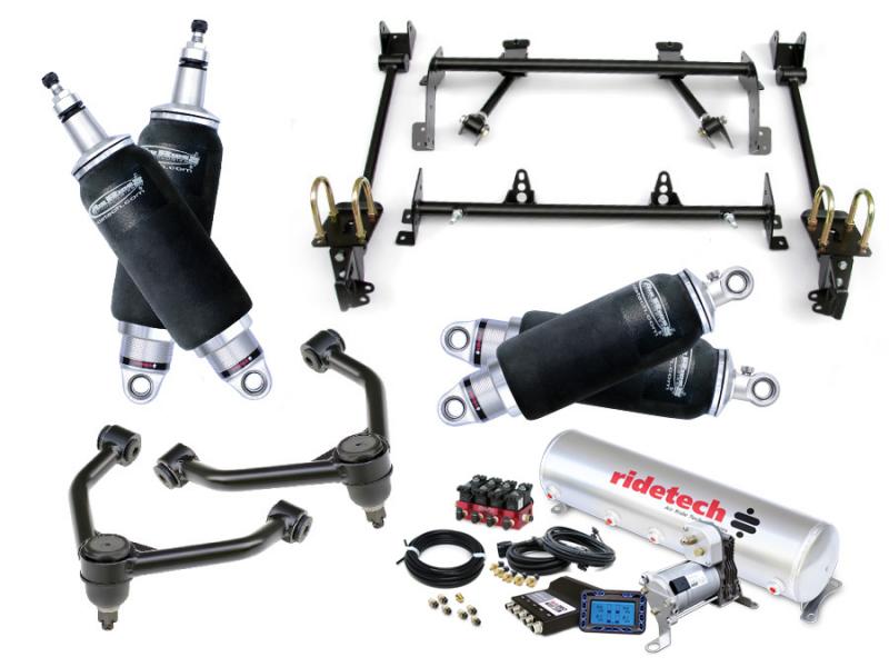

  • RideTech Bolt in front & rear Shockwave kits 68-70 Mopar B-Body $5250 available in coil-over als.jpg

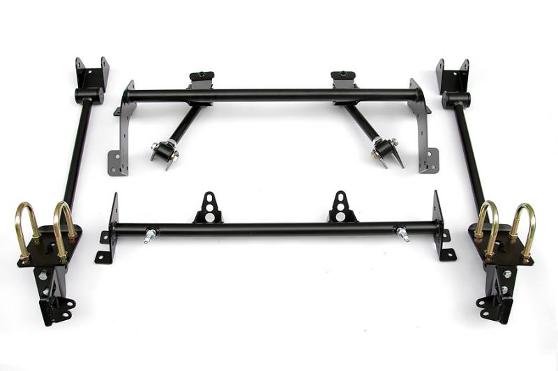

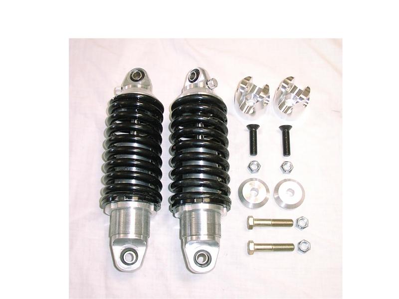

  • Magnumforce Racing  front coil over conversion complete MFR161048-6 $599.jpg
