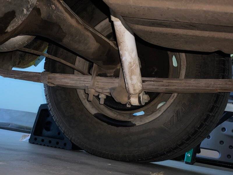

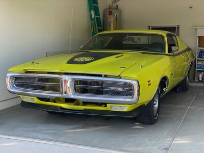

I have a 1971 Super Bee 383 that can't get out of its own way. I've already put a Borgeson gearbox in it and would like to be able to actually drive the car one day. It has factory .90 inch torsion bars and leaf springs (both have 4.5 leaves). Are your 1.03 bars going to be too thick and a mismatch for my stock leaf springs?

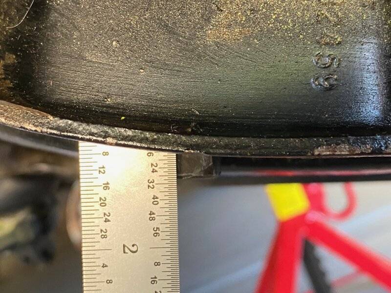

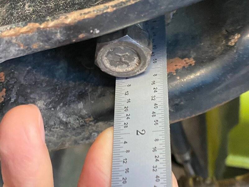

I have to screw in the passenger side torsion bar adjuster 5/16" further than the driver side, to get the car to sit level in the front. If the adjuster screws are even, the car sits over a 1/2" lower on the passenger side. I suspect that maybe the passenger torsion bar is older and more fatigued (it physically looks a bit older than the other bar). Possibly maybe the car was in a wreck at some point in time and the frame is tweaked? I don't know..

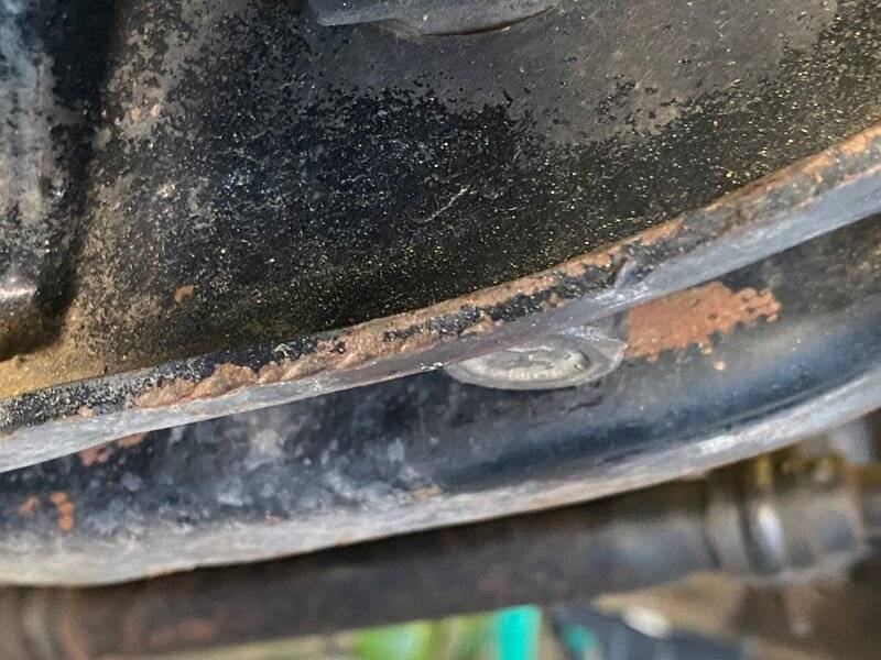

When I push up and down on the passenger side of the car I hear a noise, that I don't hear from the driver side when doing the same over there. Previous owner thought maybe it was a strut rod bushing on the passenger side, making the noise. Entire front suspension of the car was rebuilt within the past 20 to 25 years I can tell that much.. I doubt that included the torsion bars though.

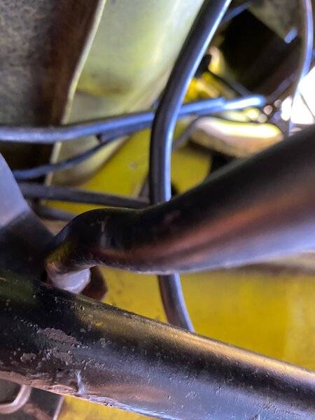

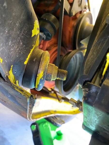

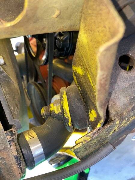

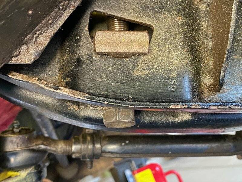

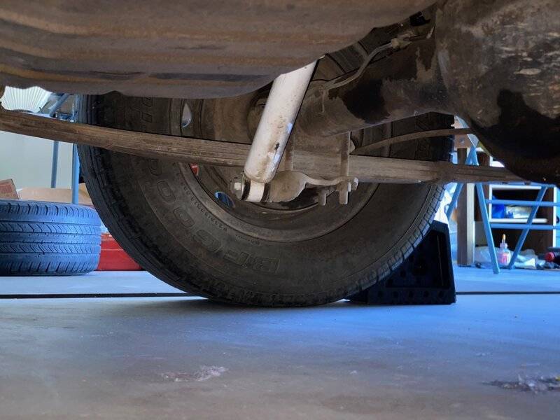

Here are some photos. I'm also worried that the 1.03" bar will not clear the Automatic column shift linkage bar that runs perpendicular right above the torsion bar on driver side. When examining the existing driver torsion bar, it looks like there is some evidence of rubbing on the shifter linkage bar that runs above it. I've included some photos of the patient. Gotta love those leaky drum brake wheel cylinders.. Like I said it ain't going anywhere anytime soon.

I'd fix the wheel cylinders and drive it. Uneven bar adjusters are not unusual. Plenty of room for the 1.03" bars, they're only .095" closer. I'd just tweek the shift linkage a bit.

Installing our 1.03 torsion bars should not be an issue on your vehicle. There would be no clearance issues. From what you describing is that the suspension is worn. I would go through the front end and specifically look at the upper and lower control arm bushings. Many times the noises that you heard in the front end are from badly worn, dry rotted and split lower control arm bushings.

Lower Control Arm bushings are likely metal to metal on the bottom.
They are one of the more difficult things to replace.
That is a picture of the strut rod not the lower control arm bushing. You need to check the bushing that is in the lower control arm that the pivot shaft presses into.
That's probably what I'm going to do. I started this thread because I'm wondering if the passenger torsion bar is older and more fatigued than the driver bar.
I already showed photos of the lower control arm bushings in another thread a while ago. Dirty Harry "Cranky", who has been banned, said to just keep an eye on the driver side bushing, should be ok as long as the shaft stays centered inside the bushing, which it has. The passenger side bushing, which looks perfectly fine to me, is on the side that makes the noise. The side I'm supposed to keep an eye on is quiet, makes no noises.
I'm not replacing any lower control arm bushings in this heat.. That is going to have to wait, until it cools off, which means waiting till the fall. When I take the car to get an alignment, if they have issues getting it aligned, then I'll consider trying to replace control arm bushings or leave it parked in the garage, until fall.
Front tires, that have been on the car for 20 years, show even wear, so the front end isn't a total disaster area.. Was just sitting 1/2" lower on passenger side when I bought it and some noise on the passenger side, that can't be heard when the engine is running.

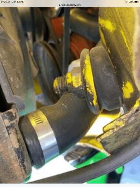

I showed photos of the strut rod bushings, because the previous owner thought maybe the noise on the passenger side was coming from the strut rod bushing on that side. But it doesn't look bad to me.. Trust me there is plenty of space between that bushing and the lower radiator hose, that photo is just an illusion.
