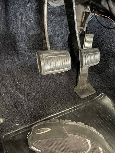

68 GTX original 4 speed. I’ve attached pics. Pedal does not come up all the way, in-line with the brake pedal. It’s a good 2-3” away. I have to use my foot to bring it up. Works fine otherwise. Over center spring is there. Clutch rod has some play. How can I get this up without “little blue pills”!! Thanks
Pull the pedal up, then set the throw out rod length from torque bar to clutch fork, by lengthening it, so that you have a 1/4" of free play (ie: needing to pull back on the fork to then make throw out bearing contact) and Bob's your Uncle. 1/4" at the fork should give you about 1" of free play in the pedal before throw out bearing contact.

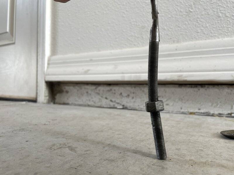

Ok, can someone school me on the pedal free play? I’m still learning about manual transmissions. I got my pedal to come up all the way with adding the fork spring and lengthening the adjustment rod. I have a new rod coming, as you can see why in the pic. Where should I see this 1/4” free play at? As I have it right now, the throw out bearing is touching all three of the fingers. Is that not good? Thanks
As I described earlier, you lengthen the rod AND while you do you pull back on the fork where the rod goes through the hole to check play as you go. So you end up with the rod lengthened and you can then pull the fork back 1/4" or slightly less before the throw out bearing hits the clutch plate fingers. You DO NOT want the throwout bearing sitting against the fingers. This will translate to about 1" of free play in the clutch pedal before the throw out bearing hits the pressure plate fingers.
There should also be a spring from the notch in the clutch throwout fork to the bellhousing or torque tube arm to keep the fork tight against the adjuster washer/nut assembly.

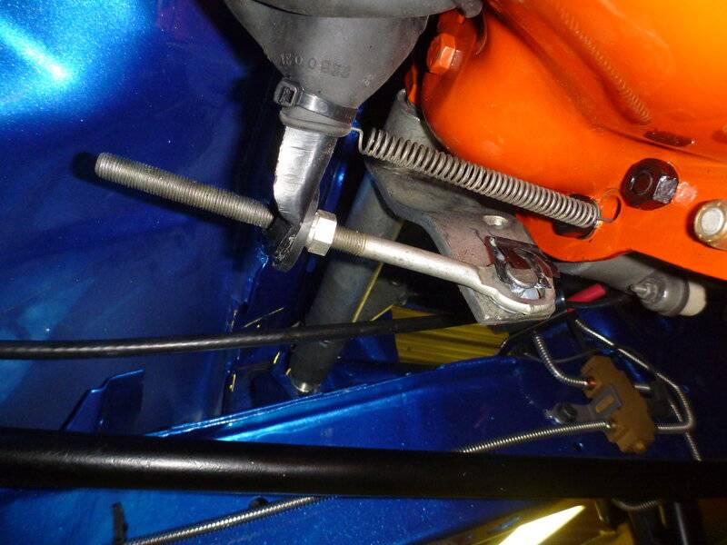

Thanks for explaining it again to me. Just wasn’t sure where I should see 1/4” free play. So, 1/4” of space between bearing and the 3 fingers? Side note, is there another nut that goes on the end of the rod after it passes through the fork? The kit only comes with one stop nut. Mine had 2 on the back side.
NO, 1/4" at the rod to fork hole.. not at the bearing to fingers. It will be less than 1/4" in there! No there is no nut behind the fork hole, that is what the spring is for. Rod, nut, washer, plastic radius-ed insert forward of the fork hole, nothing behind it.
..and the nut you show is NOT correct.. it should be an acorn shaped lock nut that sits in the washer and plastic insert.
This shot shows the nut and washer.. I was waiting for the plastic insert to ship.
