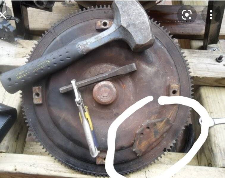

If its vibrating pull the flex plate cover off and see if you have the weights for a 360 on your torque convertor.
It's the most common thing to get off. I would look there first.

@Purepony: When you replaced the 904 trans, did you find a flexplate with a half moon shaped section cut out? Those supposed to be used on the external balanced 360's.
If that was there you have a big chance indeed the vibration is only caused by the harmonic balancer, since swapping flex plate to flywheel did not solve the vibration issue.
I am not sure if you used any specific flywheel for your application though, i would assume a flywheel for a 360 also supposed to be "balanced" for external balanced engines.
From what i found on Summit is that the flywheels are used for both applications and come with a removable weight that can be used/removed as required for internal & external balanced engines.
You really need to know what is there now to get rid of this unbalance, these vibrations can be very destructive for your engine depending on the severity.

A oem flywheel to balance for a 360 has 3 large holes holes that don't go through visible from the front side...I believe. They did that as opposed to hanging a weight.
More then likely the previous 904 was meant to be behind a internally balanced 318. It would vibrate behind a 360 unless it had a aftermarket 360 convertor or the flexplate Wietse descibed.

If I remember correctly it was a cross shaped flex plate
I did use the correct 360 flywheel for the 833 because it had a weight option and I had another vibration after I installed it. I called the guy who sold it to me abd told me to get he weight, so I did and the other vibration went away, so now I’m left with the original vibration
Likely the original setup from the 318.
I would try to get the proper balancer and check again, seems like you got the flywheel end sorted out then.
