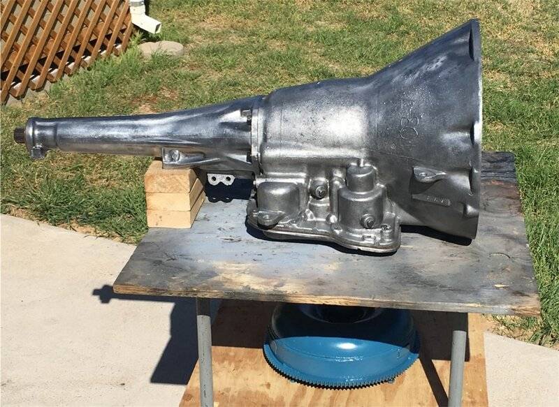

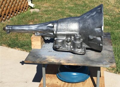

Easy Off oven cleaner is very caustic, I also use it to remove anodizing from aluminum trim. Use with open air and care.
Here is my '74 727 after a Simple Green bath and clear coating.
