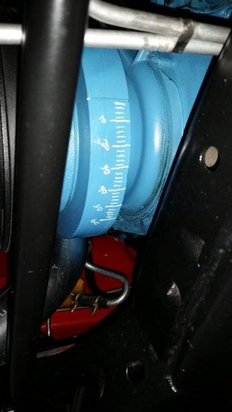

I have a 360 engine in my 73 charger and I want to install timing tape to set total timing, how do you install it and how do you read it I know it have a timing tab on the chain cover but I want to set total timing.
Clean your balancer very very good,my tape is still there after 30+ yrs. Lose the belts for better access, not sure on SB; google it, has to be there somewhere.

I tried timing tape 2 times, once just tape, second time coated with clear and both came off after a couple of runs down the street, so I just painted on some marks, not perfect, but used the third timing tape to mark where it needed paint.
I have an older Innova with adjustable dial and it is dead nuts accurate with the tape I added

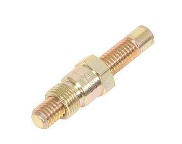

Always start with a piston stop to identify zero and confirm that the balancer hasn't slipped then put the tape on a clean surface.
What he said. After you verified its good, put some paint marks on the verticle face, every 90* or so, so that you can tell if the unit is slipping in the future.
Pop that stop in #1, remove all your other spark bolts, rotate by HAND using ratchet/breaker bar until it stops, make a mark at 0 on the balancer, go backwards until it stops again, make a mark again, halfway in between should be the cut in the balancer for the timing mark. Unless it slipped. Then its toss time and get a new one.
Also after you have done what ckessel said make sure you have timing tape for the correct size harmonic balancer. The degree mark spacing will be different if it's incorrect.
