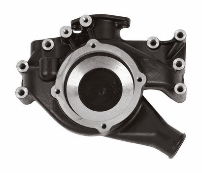

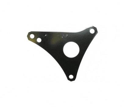

I have found at least 3. Not knowing any better, I just bought an aluminum one where the inlet is on the opposite side. I'm trying to make this one work (it's pretty), which I think I can. However, I don't know what alternator bracket to use? I have removed the air conditioning as well (just to make it extra complicated). The bracket I bought doesn't work for that housing. Can someone please direct me to the proper bracket for this housing?

Picture is the housing I have purchased, and the bracket that doesn't work.

That bracket is the correct one. You also need the adjustment arm bracket, and proper spacers.
The housing looks to have both the early and late bracket attaching holes. The early bracket attached to the hole on the edge of the water neck. Your bracket is the later one that attaches to the next hole left of it. Your biggest PITA will be that inlet is on wrong side for your radiator. Try to find a '71-'72 rad.
Your alternator will bolt through the lower hole on left side of bracket. The higher hole is for taller RB engines.

It's the same bracket for both pumps.
