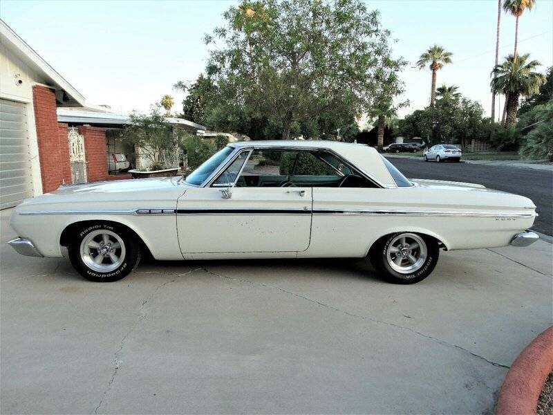

Would like to paint my 64 Fury, color is WW1. How much paint do I need and what’s the best way to go, single stage or base coat clear coat?
What all are you painting?
The entire car, 1964 Plymouth Fury, 2 dr HT.
Exterior, Jams, Trimout Hood, Trunk and Doors, and Engine compartment? 2 gallons sprayable.
Base clear is what I would go with, but single stage will cost you less.
