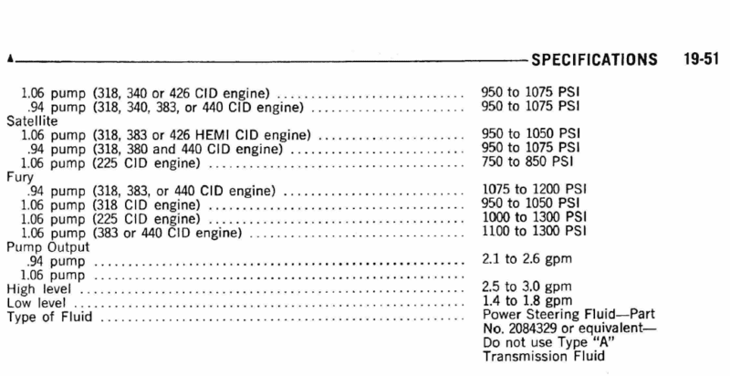

just had power steering pump rebuilt put it on worked good for about 10 miles than no power took off pressure line fluid trickles out i can put my thumb over end and stop it i also replaced the fitting that goes into steering box
The actual spec for 60's cars is nuts, like 750 to 1050 psi, depending on the specific pump. Something is wrong.
Just a tip. Hydraulic pressure can inject oil under your skin. They will than amputate your finger or the affected part.
I would avoid putting any body parts in the way of 1000 psi.
No, not nuts. Simply a function of the action- reaction surface area versus required force to do the work within the confines of the available actuator area PLUS a 20-30% pressure stability margin.
it did not have fifty pounds pressure took off last night going back to rebuilder today
