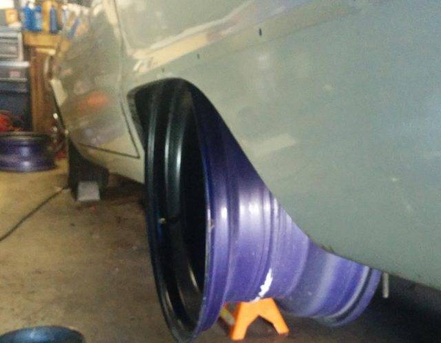

I picked up my super cool 17 inch Stocktons for my 67 Coronet station wagon today. They're the older run that use Mopar centers, 17x8 and 17x10.
I test fitted the rears after learning my car has a tighter fenderwell than 68s and up – I'm pretty tight up next to the fender, but it looks like I might be able to get away with it with just rolling the fender lip up some. I can't tell how much clearance I'm going to get for the tire further up inside of the fender though.
I'm planning on using a 255/40-17 tire, so it's going to be a bit of a stretch on the rim (not much sidewall poking out) and about 4.5 inches tall.
Here's what it looks like bolted on. I have the weight of the car on the axle in these photos

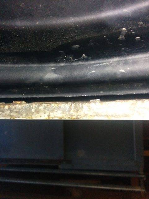

And rim-to-lip clearance:
Could I get away with it, or am I going to have to do something to the fenderwell to keep from rubbing (and what?)? I have an anti-roll bar on the rear but I do load up the car a bit sometimes.

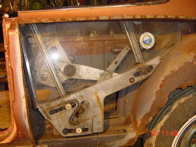

After I saw your post though I got an idea, and I finally found some photos of this platform without the rear quarters on. It looks like the fenderwell is constructed no different than you'd think:
I can see how the narrower upper section would be pretty resistant to bending outwards (you're asking the upper section to stretch unless you get the side metal pliable). If heat doesn't do it, it looks like I could just buzz out the offending section of the fenderwell and install a 90 degree box in its place.

A little under an inch maybe? The second picture on my first post shows the fender lip, so that plus my little cardboard-width gap there.

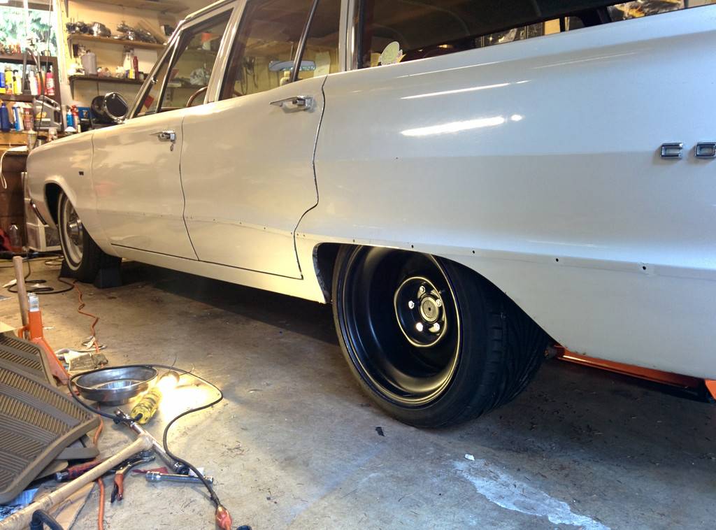

Take this, naysayers:
I rolled about 10 inches of the fender lip up about 50 degrees and I don't even need to mess with the fenderwell for this tire (too-short 255/40). The 255/45 I was planning on should only require a dent at most.
