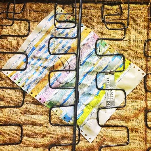

Sometimes you can find one of these in an old Mopar... broadcast sheet:
