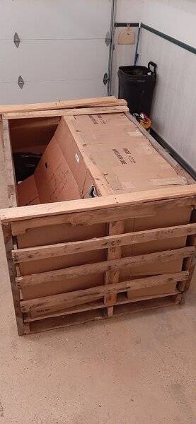

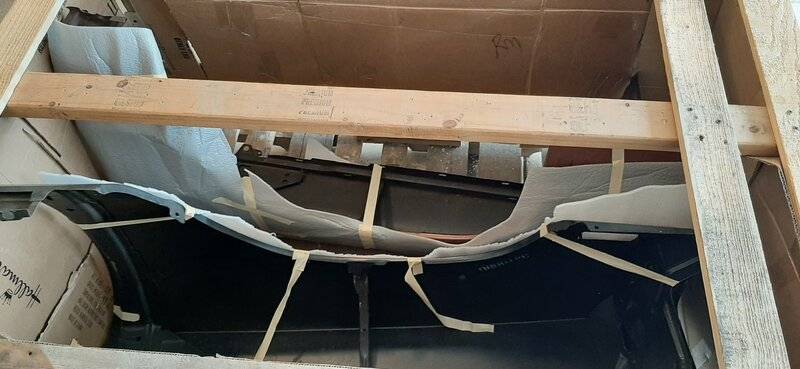

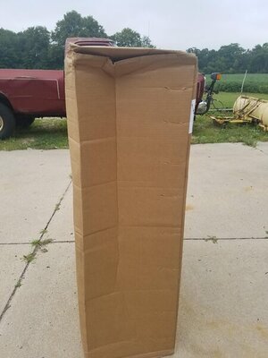

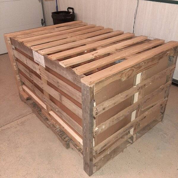

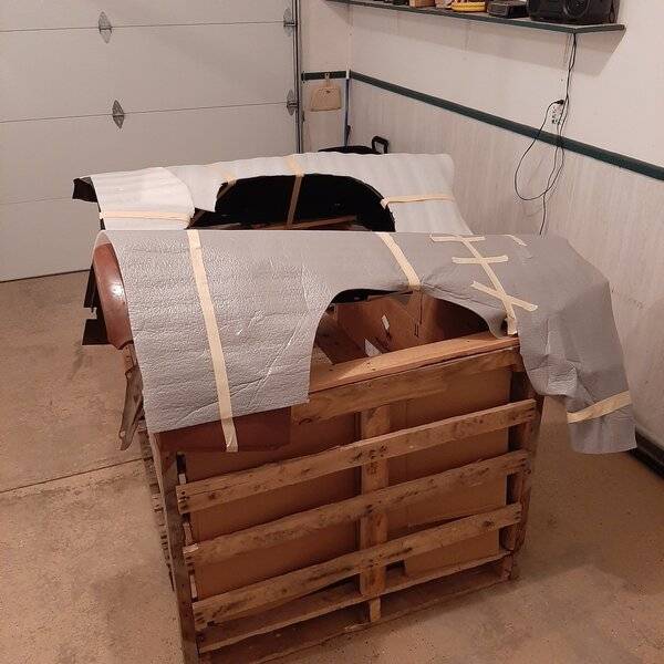

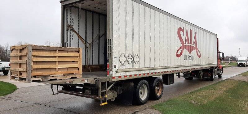

I shipped two NOS Front fenders to Florida and this is how i did it....
Phone #1 414.jpg Phone #1 421.jpg Phone #1 430.jpg Phone #1 432.jpg Phone #1 442.jpg Phone #1 443.jpg
How much was shipping on those? I shipped a really nice 70 Cuda fender using thick cardboard and double laying it with extra protection on the front edges etc. It got there in decent shape except the lower part behind the wheel opening was bent a bit. The buyer said it was easily fixed. After that, crating was the only way I was going to do that but never sold anymore fenders and shipped them.
I built and supplied the crate for Free, Freight was around $400.00 to a Business the Florida. Thats the only way i will ship sheet metal or Rare Mopar items...

Saia trucking has done wonderful for me. My new Glen Ray radiator was shipped by speede delivery and was perfect !
They used to, it’s been a few years for me. They were advertising they did , Saia. Speede was to my door from Glen Ray.
I just checked saia web site it’s to a business only now a days . If you have a local mom and pop part store you could ask them. Looks like Saia does have Tommy / door lifts on the tailgates . So they will be able to load it. Quotes are avail of you have your p/u destination addresses avail.
