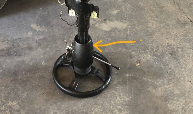

Turn the collar on the column from the inside, just forward of where the key goes in.
I cut the lever off when I converted to the 5 speed Tremec. When going down the road, vibrations will sometimes "clock" that collar and it just needs to be twisted counterclockwise to be placed back into position.
You can turn it inside the car on the column. The most forward part of the column housing moves as it's connected.
Pontiac Trans Ams and Camaro same way when they have floor shifters.
That would make me a little bit nervous.
The "floating" collar does not affect the locking feature of the column. the key has to be turned back to lock it. The collar just affects the ability for the key to turn to and from the locking position.
