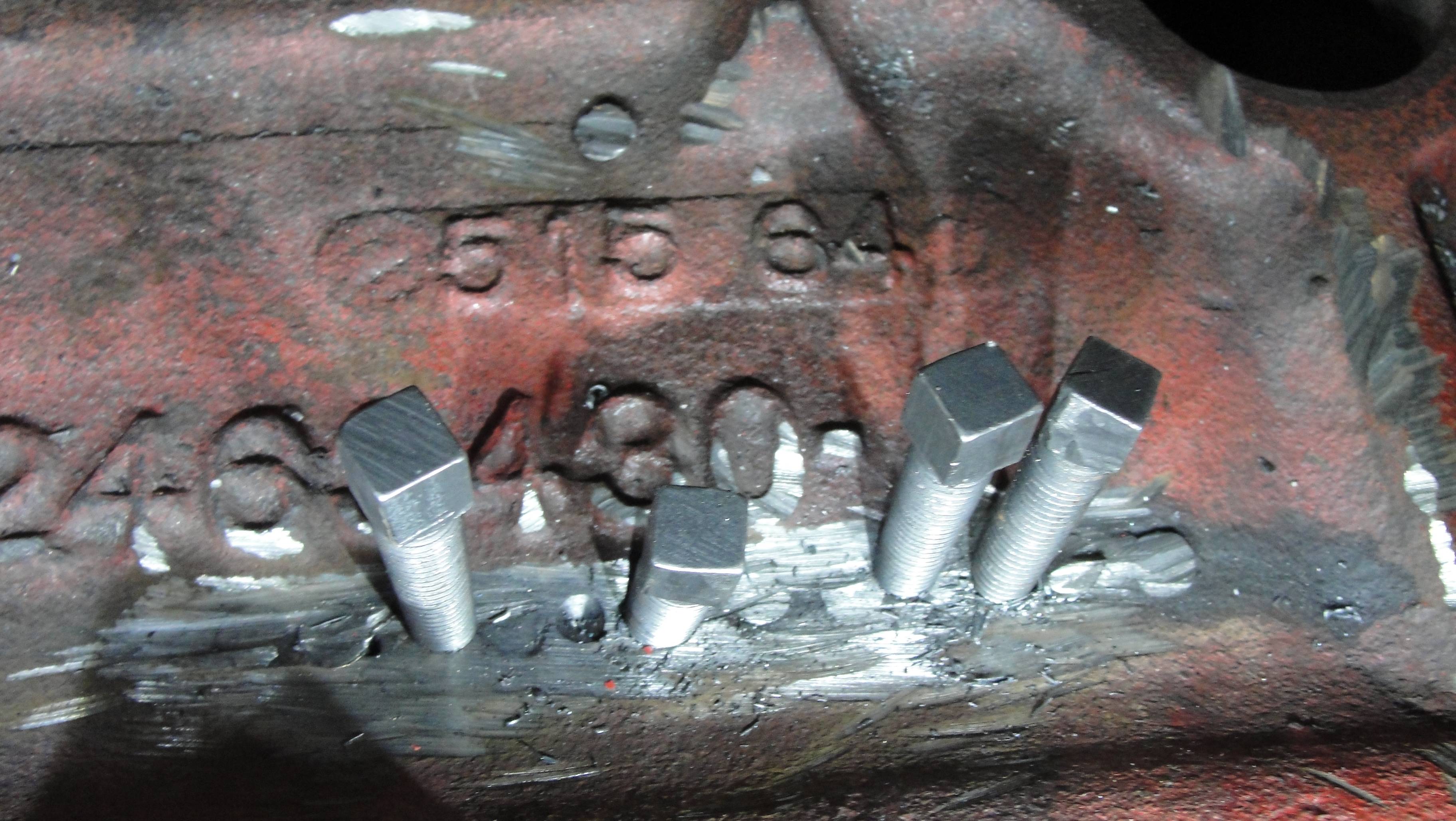

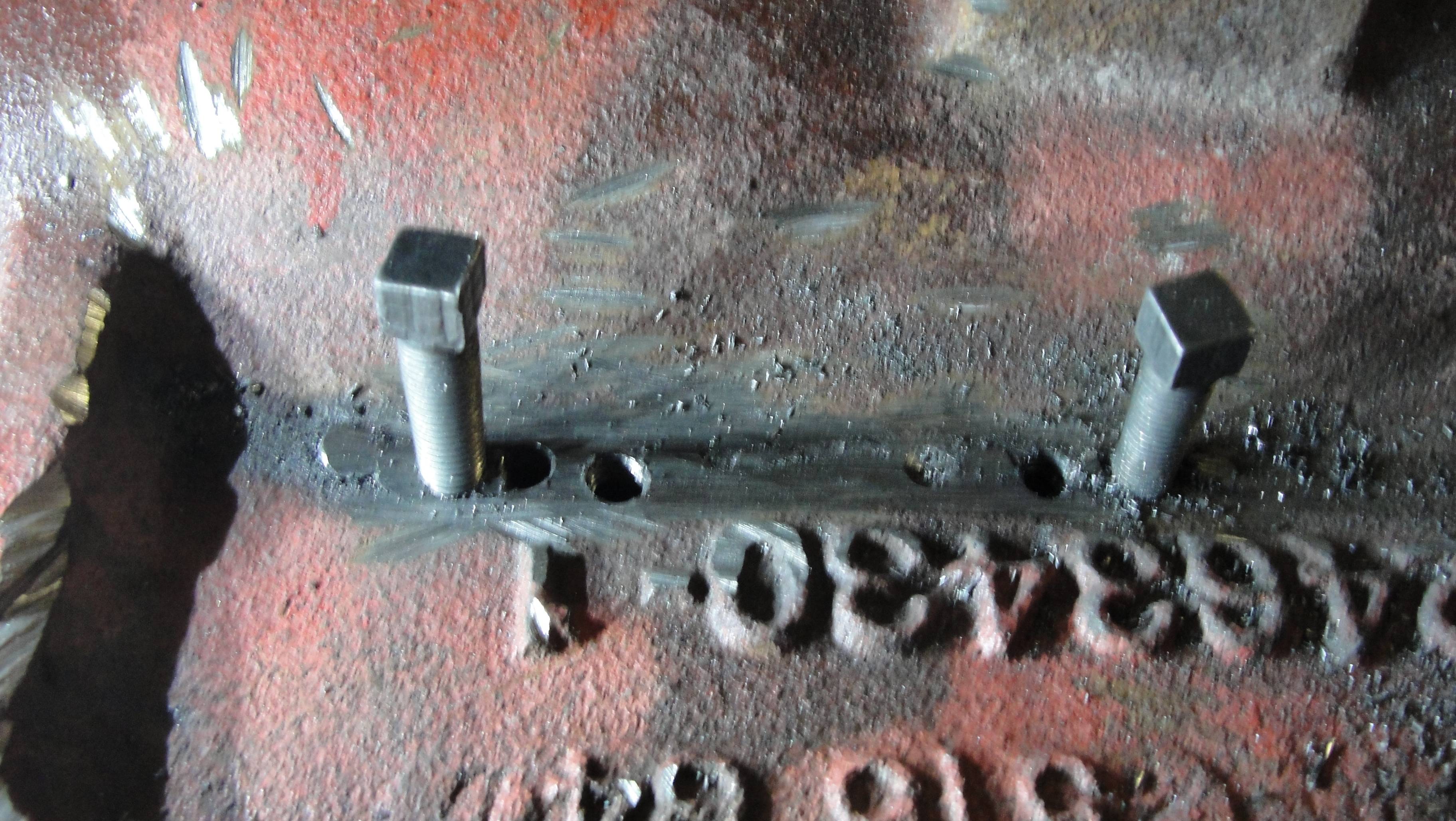

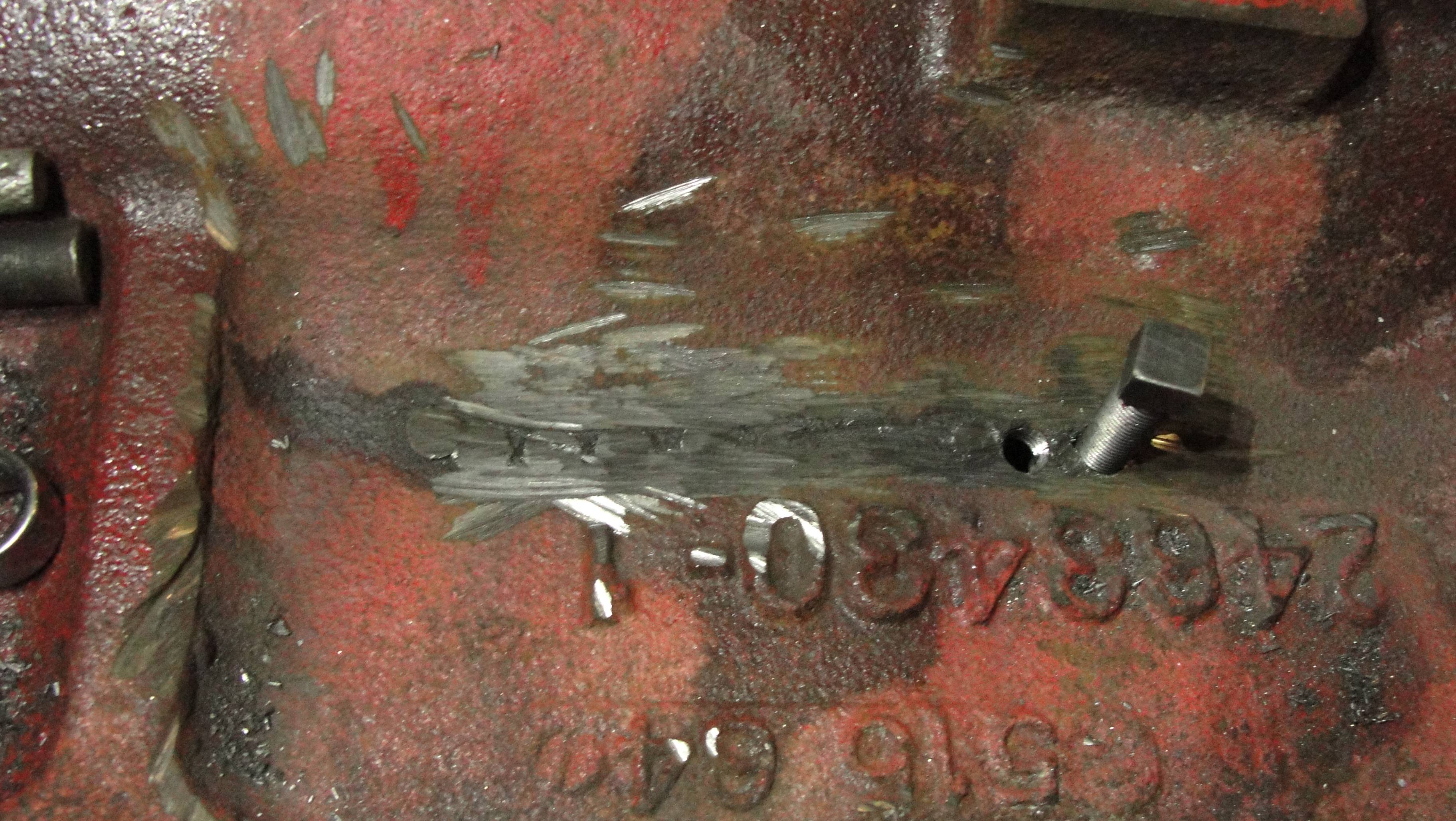

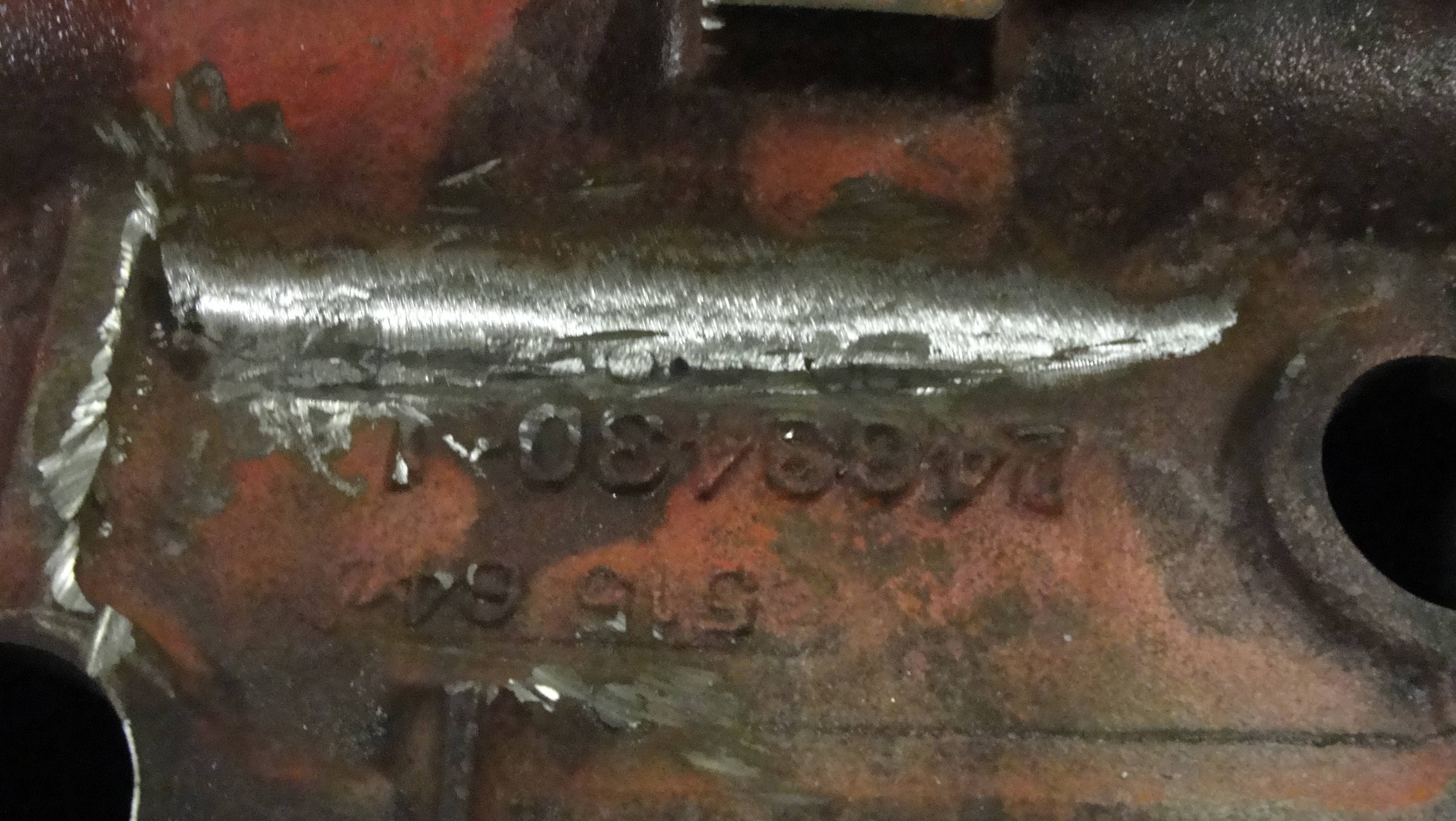

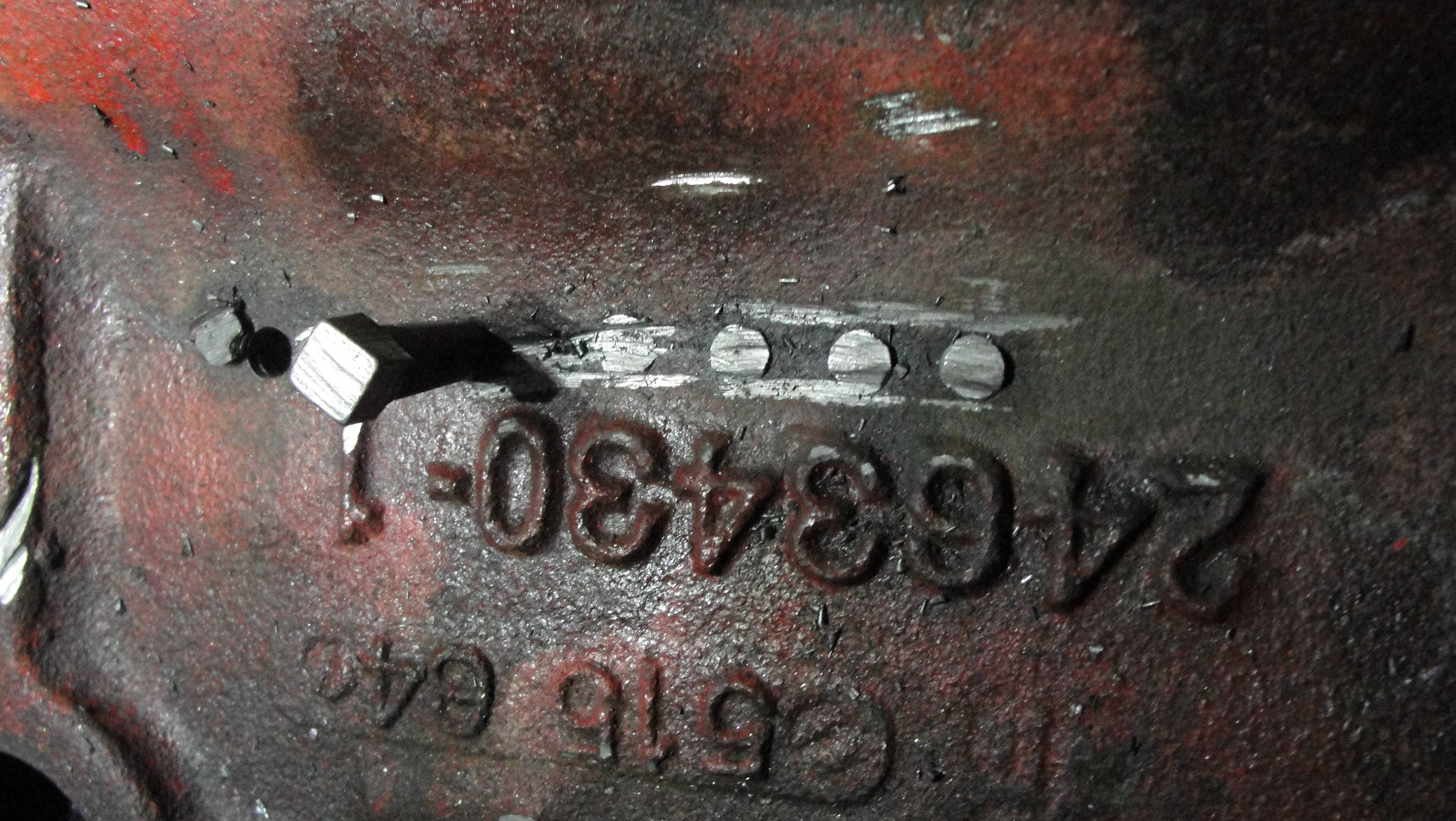

This is the method I use to repair cracks. The longest crack so far is a 17" one in a '54 GM 235 block.

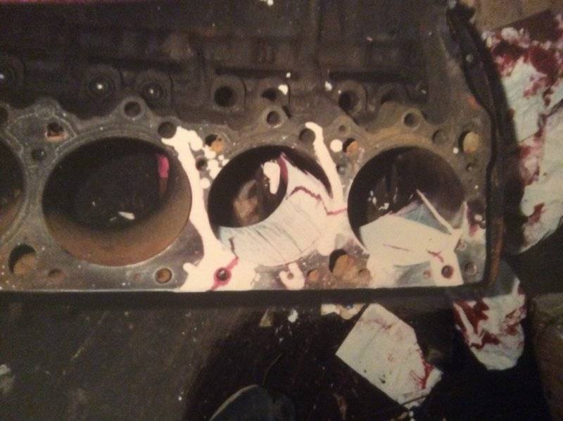

Would it work on this?:rolleyes::rolleyes::rolleyes::rolleyes::rolleyes::eek::eek::eek::eek::eek:
I've watched videos on lock n stitch crack repair and it has to be some sort of black magic wizardry.
Dang....overdrive the blower too much? :D
Careless second owner! Had some parts stolen so took to a garage he was friends with. They pulled the engine put it and the car outside in back. He threw plastic sheet over it. After a couple of years plastic gone two cylinders full of water froze. When went to buy the car agreed to pay him $800 for the car and engine but had to check out the engine. Knocked price down to $500 and a friend offered a complete Hemi for $1,000. This was in 1978.
