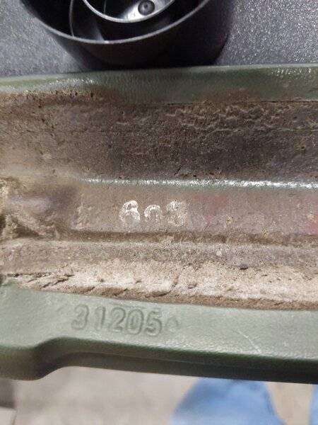

Thanks for the dialogue, that discussion is what I was after.. I have the dash pad out of the car and I believe it to be original. How do I get a date off of it?

THERE should be a stamped in colour date of manufacture
What can you make of this? Thanks
Looks like 60th day of 68
Thanks, so navigating without a fender tag or build sheet. The interior is F8 green but the 430 shade which is the 1968 shade of F8. The car seems to have been built maybe about January 69... I have been trying to really just figure out what was going on here.. thanks again.. Jay
Not really sure what that decodes,but if you check your engine block on pad by distrbutor n has a date n it will be close close to build date like within 1-4 days nif that fails your seat covers especially the upper fronts will have a stamp date if orginal
Day 60 would put at Feb 28 of 68. That's data that you could put with another OEM part to hone in further.
You can definitely gather a timeline with more parts.
