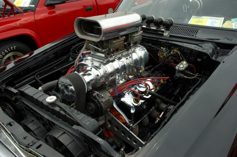

Hahaha I knew I'd get that response at some point, I do have a full 10 lb bottle of nos but it's for decoration, I'm not putting nos in my car
Nitrous is a power adder that requires you to refill the bottle all the time.Boost comes from a supercharger or turbo charger.There are centrifical superchargers that go on the front or the roots style that bolts right on the intake manifold:grin:

^^ thank you for that info, i just saw the 13:1 compression and just about freaked, i kinda didnt believe it haha, and HEMI-ITIS, whenever i saw boost written i almost always saw nitrous, haha, hmm if i do a supercharger or turbo itll probably be on a smaller cr later on in life, i wanna put this car close to original with little engine upgrades
