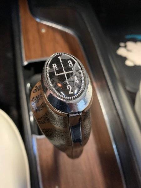

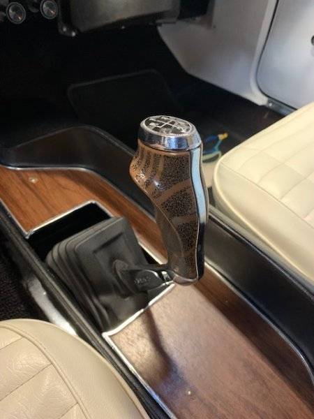

I am in the process of replacing my old worn out 4-speed Hurst Pistol Grip on my '71 Roadrunner. As you can see from the pictures, the lens on the old one has a cracked bezel... the older grip was a pretty faded too.

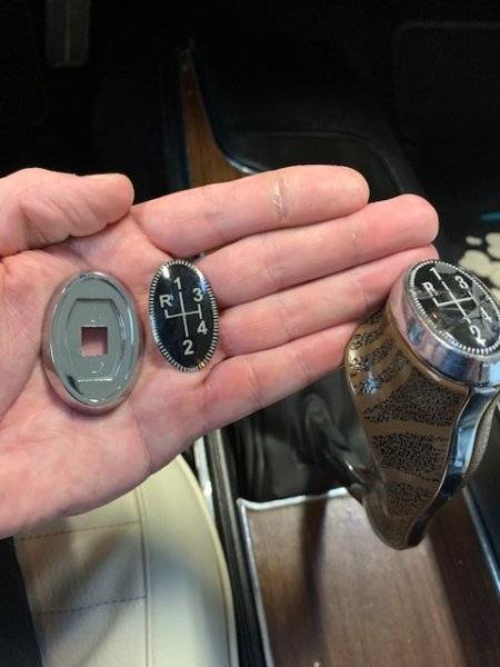

I was able to replace the grip as you can see, but I can't seem to figure out how the lens stays inserted into the bezel? The old grip's bezel looks like it was somehow pressed around the lens.
So, I left the new grip on there with the old lens and bezel until I can figure out how to secure the new lens into place on the new bezel. Oh, and please go easy on me... this is my first ever classic car, let alone a MOPAR. I'm new to the game but I'm a quick learner! Thank you everyone!

Its held in with double sided tape. I'm surprised the new one didn't have any on it !!
So how do you plan to attach the new bezel? Originals had the metal peened over to retain them.
I would remove the plastic handles and then pop out the old lens so you can see how the bezel is attached to the shift handle. It's peened on but you might be able tap it off with a hammer. I used jb weld to attach the new bezel to the shift handle on mine. When the jb weld is dry then you can attach the lens to bezel with double sided tape.

Thank you both very much for the info! I was not aware the original metal being peened over the bezel!
So yeah, it looks like I'm just gonna put on the new grips and keep the old bezel on there. It's really not that bad and I was more looking to replace it out of boredom. It does have some inner cracks but I suppose I'm gonna hafta live with that.... I wasn't looking to make a major project out of this!
That's what I get for trying to fix something that ain't broke! haha
