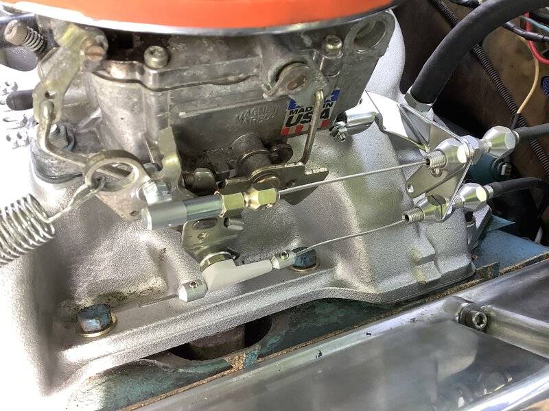

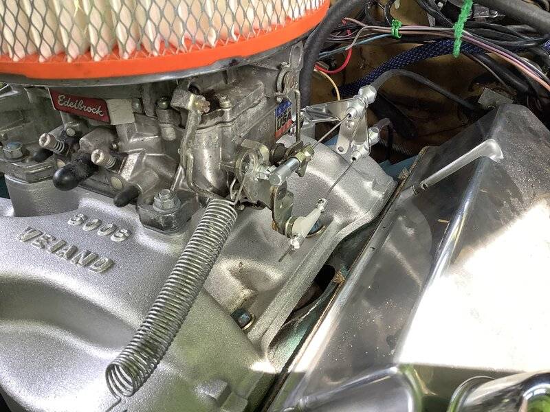

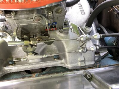

I put a Weiand 8008 intake on and also installed Lokar throttle and trans cables. According to the Lokar directions for the trans cable the throttle wide open and then pull the cable tight and tighten the keeper on the cable. This is not working for the transmission, so I have been gradually putting more slack in the cable with the throttle closed. It’s getting better but the shift to 3rd is still too hard. There’s no return spring on the trans lever like there was with the old linkage and I am hoping someone here has been through this and can give me some direction here. Thank you.

Post a closer photo of the linkage, it is difficult to see it in the photo above.

Ok...1st make sure your throttle cable is adjusted right and you're getting WOT with the pedal on the floor...on an edelbrock I thought you needed that Chrysler adapter? On my holleys you do not need anything.....I put a heavy object on the gas pedal to keep the carb at WOT, then pull the kickdown cable until the lever at the trans is pulled all the way back then lock it down...they key to this working right or not is the length of your kickdown lever, you need to use the shortest lever possible or drill holes in you current one to change the amount of travel...I used the shortest factory one I could find and it worked perfectly.....
As far as a return spring at the trans side, I am using one. It helps return the lever when you come to a stop, if not you might be taking off with that lever already partially through its range of travel..

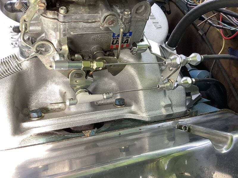

Hard shifting is what happens when the linkage isn't hooked up, or isn't generating enough line pressure. You've got way too much slack if you're running it like that...not good.
Those don't look to be installed properly. You don't want that extra loop in the cable housing like you have on the top cable. They should both be mostly tight when at rest, the kickdown cable should have maybe 1/4" or so of free pull before it starts engaging; you'll feel the tension from the transmission end when testing it by hand. When the throttle return springs pull the throttle closed, the cable will return the kickdown to it's resting position, that's why you can't have extra length on either cable.
FWIW I've never had any issues with shift points once adjusted properly, never drilled anything to change the geometry and it's worked flawless on 3 engines...
Maybe this will give an idea and get you close, he's demonstrating the amount of slack in the cable before tension is felt.
Have all 3 of these engines utilized the same length lever at the trans? Maybe you got lucky and started out with the short lever on all....the long levers need holes drilled closer to the "pivot point" ..

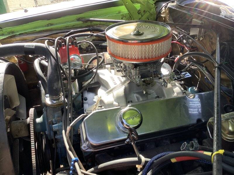

Hopefully these pictures are clear enough to see details. I put a 2nd cable stop on the back of the trans cable to see if that would help the cable push the lever back on the transmission, but haven’t test driven yet this morning.
Is this adjustment made with throttle wide open? That’s how I did it initially according to the Lokar instructions. I am probably making this more complicated than it is...:BangHead: :BangHead:

Also I shortened the housing on the transmission cable about 4 inches to make sure to have long enough cable.

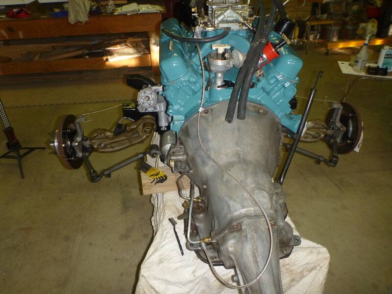

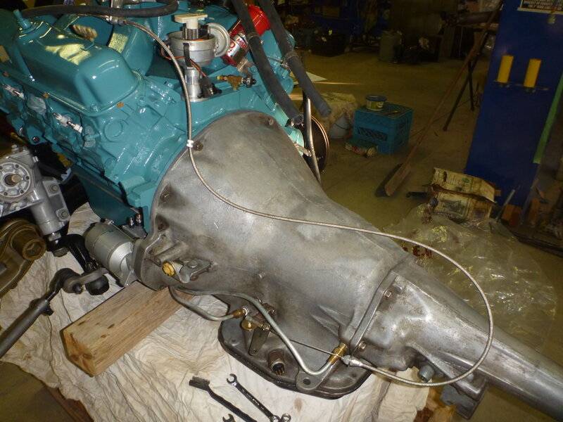

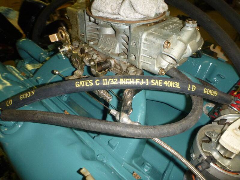

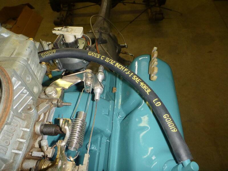

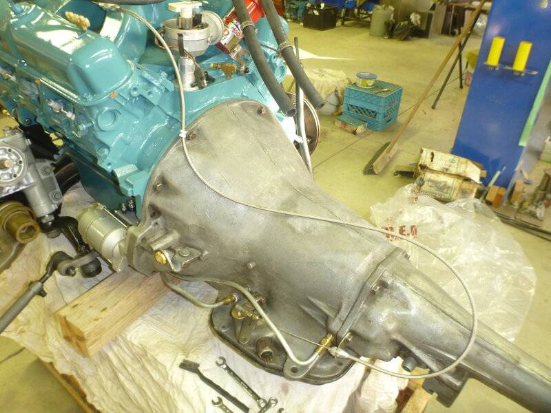

Mine on the Dart.... hard to see, but note the long lightish spring in the final picture from the kick down lever to the shifter bracket to help pull the cable back.

I have double checked and verified wot with a mirror down the carb so the throttle looks good and now I have a different starting point to adjust the KD cable and see if I can dial it in.

Lots of fun and done :thumbsup: Made very small adjustments on the cable stop after each test drive and found the sweet spot.
Wow is this going to be a nice improvement and I also installed a soft spring on the trans lever to help it return to rest.
