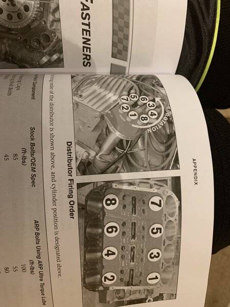

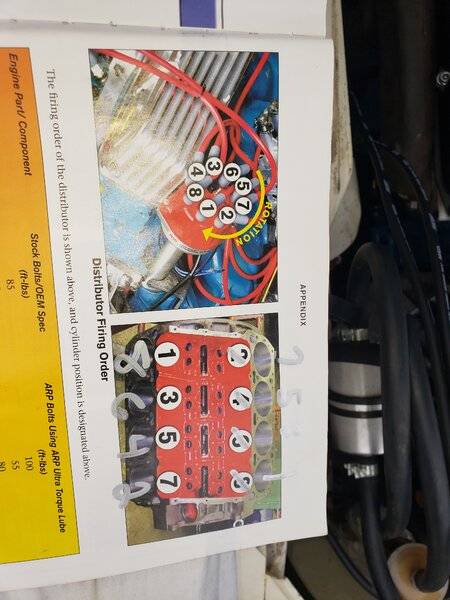

Has anyone else who has bought this book notice problems with it? In the appendix they have the cylinders numbered improperly and also they show the firing order going clockwise on the distributor. Would be a real bummer for somone who uses that section for reference while using the book. Thinking cylinder 8 is cylinder 1 could cause some issues lol. I wrote the cylinder numbers in myself but then noticed distributor as well lol.

They've all got some errors I'm sure....but that one will really ruin somebody's day if they didn't know better.

This is the book I have and even it has a few mistakes like they all do I guess. The how to install left & right rocker arms were backwards.
