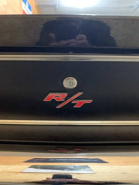

I have a stick on R/T emblem on my tail panel with no Charger emblem. How do I remove it without marking the tail panel?

It's on the tail panel. Put on at restoration 5 years ago, not factory.

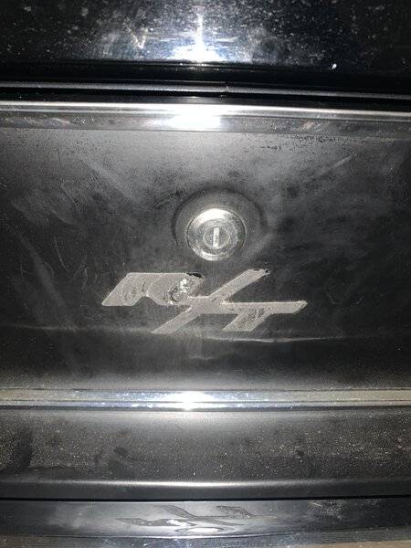

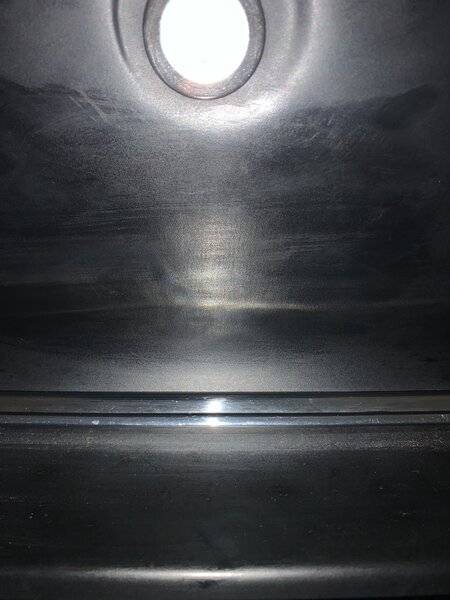

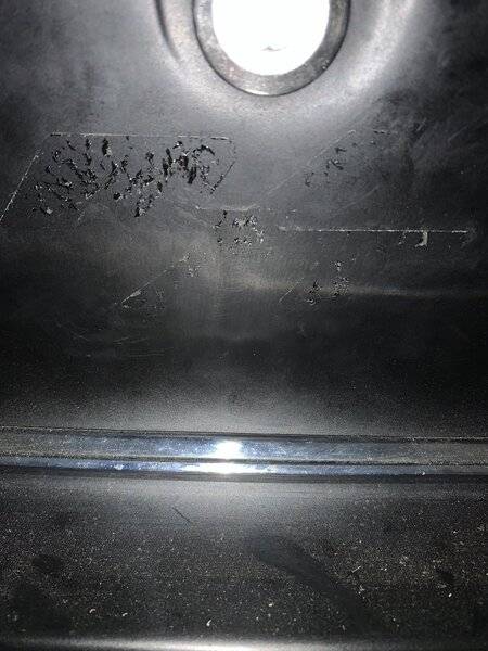

Well the dental floss did the trick to get the emblem off. Then I tenderly peeled the sticky off with my thumb nail and followed up with some Goof Off. There's exhaust residue on the tail panel so tomorrow I'll take some polish to it and it should all be good.

There is a rotary tool, called an "eraser" that works the best to remove the adhesive residue. Contact any automotive paint store.
One may not want to spend the money for the tool for one emblem, though.
