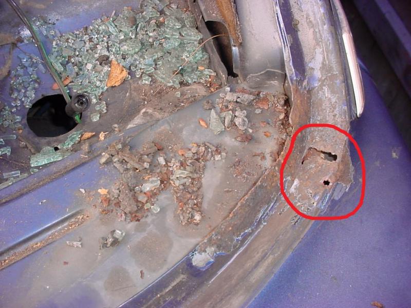

Coincidence, I just came in from removing my rear window trim. Same issue. Two BB size holes at the corners. The leak does not appear to be under the window seal thankfully. For now I am plugging the two holes with some "Right Stuff" sealer I had around. We'll see how it holds up but this stuff is tough. The correct way would be to weld it shut but afraid of ruining surrounding paint. That channel under the trim that runs off to nowhere is pretty poor designing. Just asking to trap water and cause issues.
Getting the trim off is a little tricky but once you figure out how to get one clip off, the rest come easy. You can get a tool at Autozone. Best I can describe it is lay tool flat(or close to it) against glass and slide under trim until you hit a clip. You want one of those hooks on the tool to get under the clip. Then lightly pry on clip with tool then twist. Should pop right off. Start with corners.
