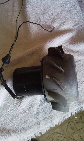

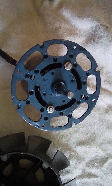

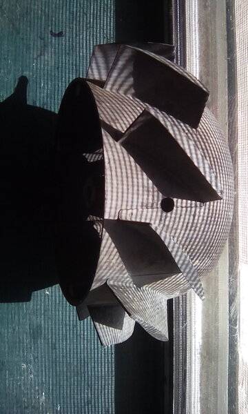

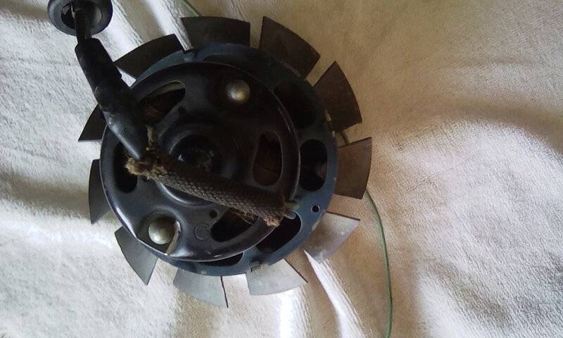

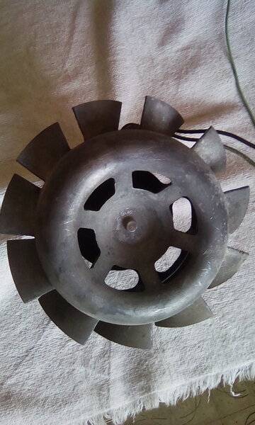

Does anyone know how to remove the fan from the heater/blower motor on a 1964 Dodge 440? I do not have A/C.
Have I stumped the community with this one?
There is a blue ring that is at the base that attaches the whole assembly into the blower housing with 4 long screws. If both are press fitted to the motor, then if nothing else, I might, unless someone can tell me that I am wrong, try and pull the two parts from the motor itself.
I see that the replacement motor is available on eBay, but without the fan, nor the blue ring that would be needed to once again assemble the whole thing together.
I really am at odds with this one for sure.
If nothing else everyone, Thank you for reading this post.

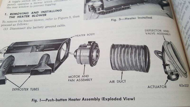

Looks like the same as a '62. The service manual doesn't mention anything about replacing the motor, just how to remove the fan/motor assembly. However in the trouble shooting it mentions a loose Timmerman clip. That might be a clue. (Maybe the '64 manual might be updated to include replacing the motor.)
If the clip is installed on the shaft to hold the fan to the shaft it looks like yours is already removed? Maybe spray a little penetrating oil on the shaft and fan and let it soak. Then using a flat punch just tap on the end of the shaft and see if it moves.

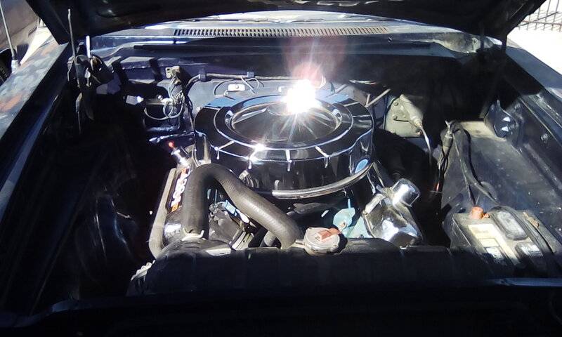

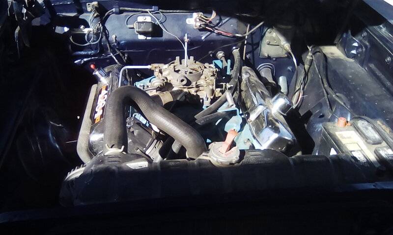

My 1964 Dodge 440 is a 2 door sedan original 426 street wedge with a 4 speed, paint EE1 with a light blue interior. I've had it for over 40+ years and just now getting around to getting it back on the road once again. Engine & 4 speed done and installed, now the heat/blower & just electrical issues before paint and interior.
IMG_20210221_142348.jpg IMG_20210221_142426.jpg IMG_20210221_142613.jpg IMG_20210221_142641.jpg IMG_20210221_142702.jpg
I live in the desert, and if you water as necessary to retain a lush green lawn, well good luck with that water bill. LOL

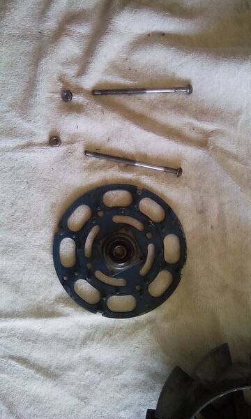

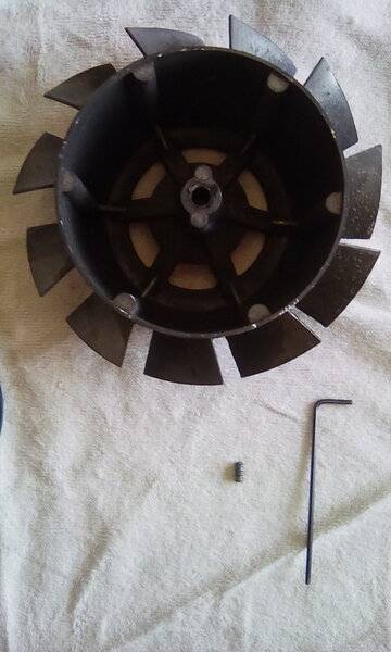

There is a small hole in the fan where you have to use a Allen Hex tool to remove the small screw inside that holds the fan to the shaft. Using a small punch against the tip of the shaft, gently hammer it pushing it down through the fan. Using a 3/8 socket remove the nuts that holds the plate the blower motor by press against the shaft. I used a small press which worked well. This gives you access to the blower motor itself.
I hope that this helps someone else with the removal of the fan and access to the motor itself.

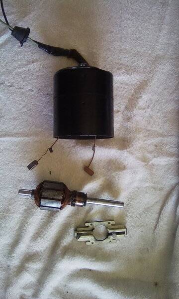

Does anyone know who can rebuild the blower motor?
IMG_20210223_121912.jpg IMG_20210223_123931.jpg IMG_20210223_121847.jpg IMG_20210223_123922.jpg IMG_20210223_123911.jpg
View attachment 1076754 View attachment 1076757 View attachment 1076759 View attachment 1076761 View attachment 1076763
So there is a set screw! Good info :thumbsup:
Any electrical place should be able to rebuild your motor. Look for an older outfit that's been around for a long time in your area. I'd try that first before having to ship it out somewhere.
