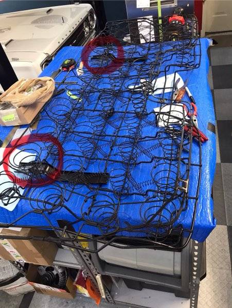

There are two bolts at the bottom of the seat back that secure the seat to brackets on the axle hump. You need to get your head down low and look up underneath the bottom to see them. The upper part just slides out of brackets once the 2 bolts are removed. Brackets with slots that bolts secure to are in red circle. And yes, the armrests need to come out first.

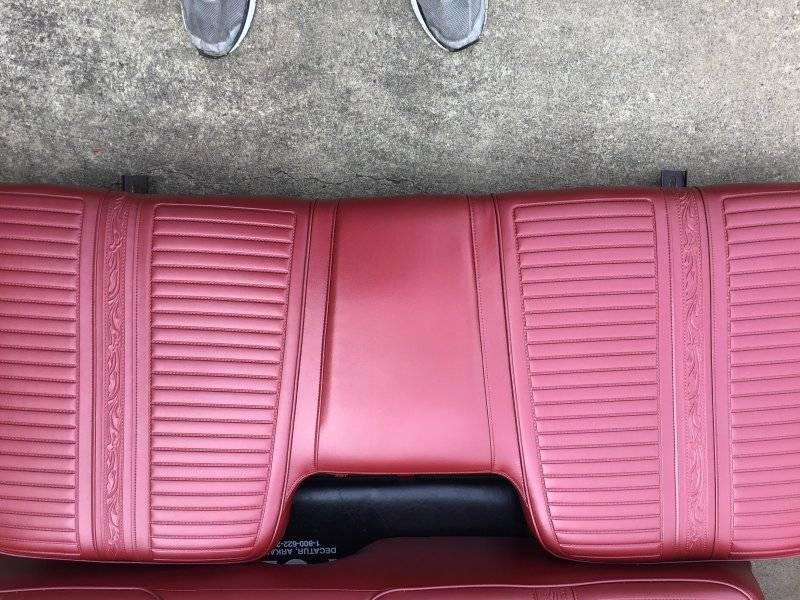

There are no bolts securing the seat back on a 2 door 67 Satellite. There are metal tabs that go through the seat frame and bend over to secure the seat back.
The metal bracket is not installed back there for bolts to screw into.
There are bolts in a 4 door 67 Belvedere seat back.
Well I don’t know Scott. That’s my 67 GTX. Nothing molested or changed back there, brackets, screws, everything just as the factory installed and exactly the same as my 66 Satellite. Just removed the factory rear seat covers a few months ago. Still original foam, burl, listing, etc. Maybe a mid-year change or something. You can see the slotted brackets below the seat back on the first photo with the original upholstery still on it.
