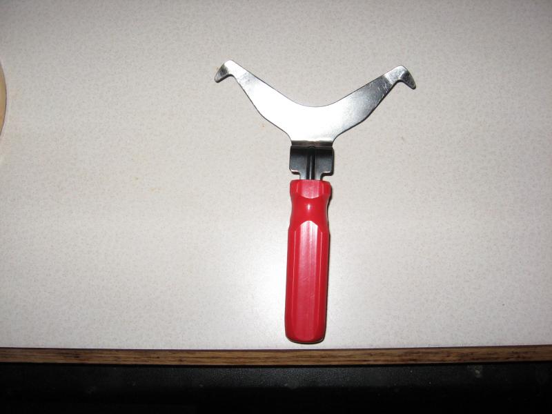

And where do I get this tool from?
IMG_0612.jpgI bought this tool at napa, and it worked just fine on my car. don't have the part number for it but there was only two differen't kinds, this one was actually for gm, ford. I tried the chrysler one first and didn't seem to work for me. Hope this helps. Darrell
Is the tool just inserted under the chrome trim pieces and then pry up?
This is the one I use. Works pretty good.

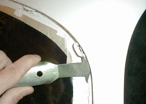

You pry to the side

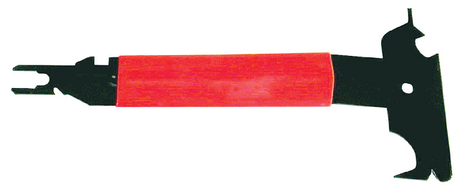

Here's the tool I have.
The hook on the lower right is inserted behind the clip then you give it a little twist and a bit of a lift & then the trim pops off the clip. I bought this one at Princess Auto here in Canada, but I'm sure there are others available at any auto parts store. This is one of those things that are hard to describe, but quite simple to do. When I did the Sat it took me less than 5 mins to pop the trim off the windshield & backlight in less than 10 minutes, and I had never done it before. There are a few videos on Youtube, just Google Windshield trim removal.
