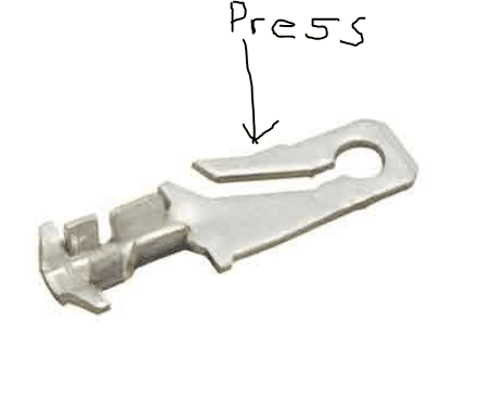

I use a jewlers flat blade screwdriver and slide in from the bulkhead side of the plug, along the side of the thin leg of the blade terminal and pry the leg over to release it from the notch in the plug body. Pull it out from the wire side. If you need to remove one and reinstall the same terminal be sure to spread the thin leg on the terminal back so that it catches in the plug.

You don't need a tool. Push wire into connector from rear, bend tab with small screwdriver, pull terminal from rear of connector. When reinserting bend tab back out, push terminal into connector until it clicks, tug slightly on wire to ensure seated.

Small needle nose pliers from the spade end not the wire end. Squeeze and pull the wire end.

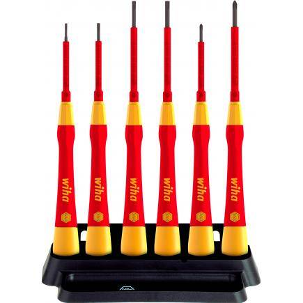

I will get me 2 of these and practise:
Just don't know who sells the best quality ones.
Just about all the terminals (male and female) secure either with a little barb on the top of female ones that can be depressed with a small screwdriver, or the little leg on the male terminal that catches on the plug. The turn signal switch plug uses kind of a rectangular barrel clip but they use the same basic little barb that catches in the plug and has to be depressed for removal.
