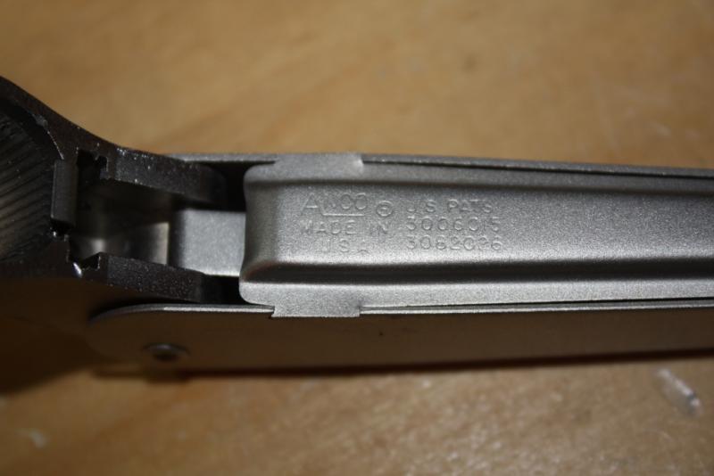

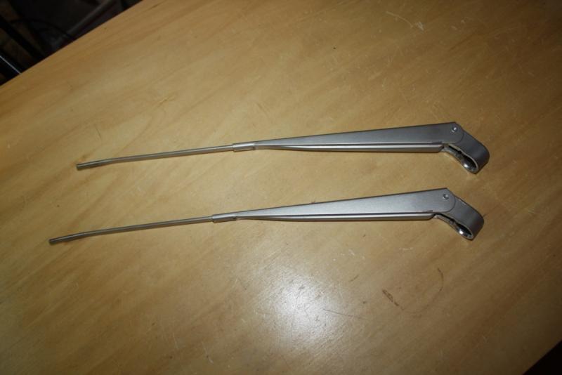

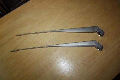

Don't buff them. Way too bright. The finish can be brought back. Get the finest glass media for your bead blaster and lower the pressure. Start far away and work inward. They clean up pretty well. The set in the picture below was pretty rough before I started.
