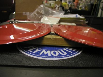

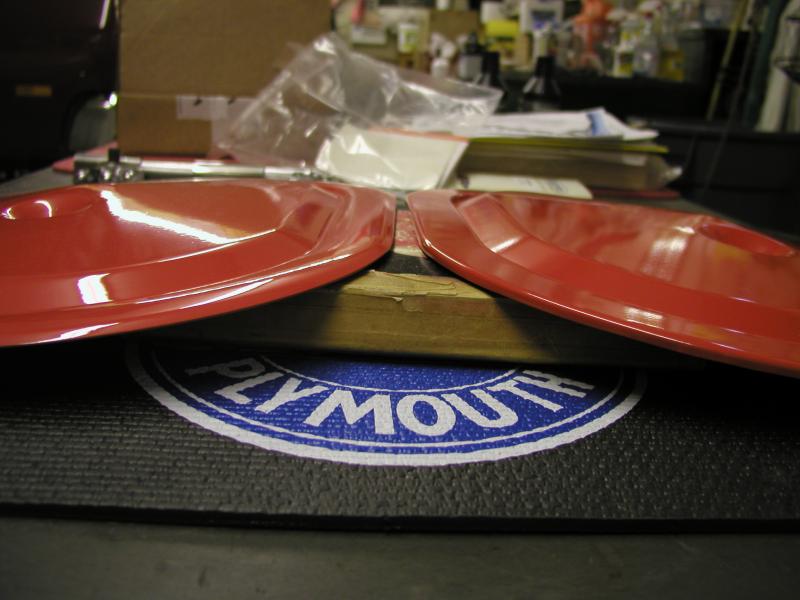

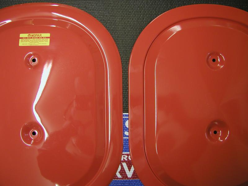

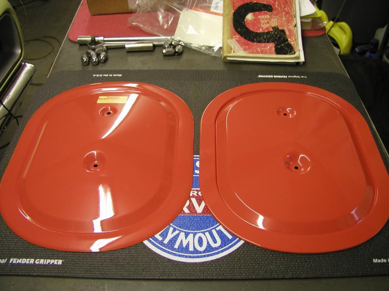

From your photo, it looks to me that you have an NOS lid there. The way to tell is by the definition of the bends from the metal stamping. The NOS is very crisp and well defined with an almost 90 degree bend downward on the outer lip/edge. Repro is more fluid, smoother, and less definition in the bends/transitions of the metal. I just went to the garage and took a couple photos of mine to show the differences between repro and NOS. Hope you can see from these photos.
BTW, repro is on the left and NOS is right side.
