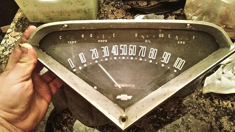

Hello all please teach a young guy something . I have a general idea but want to be sure before I brake something!
I have a cheap chevy set from the 50's I'm working on. Do I just add power and ground? How much power? ????

I have a cheap chevy set from the 50's I'm working on. Do I just add power and ground? How much power? ???? View attachment 1099468
55, 56, or 57 Chevy? Chrysler went to 12V in 56, I'm not sure on GM. Most gauges can be checked individually with a 1 & 1/2 volt battery.
It's not a 1956. BTW, '56 was 12 volt. Touch 12 to them for a fraction of a second and if they move, they work, more or less, more more than less. Won't know how accurate they are until used.

An ohm meter can test the gages. You will need a baseline test ohm value which will vary upon the gage and manufacturer. If you have a zero ohms or a closed circuit, either could indicate shorted internals.

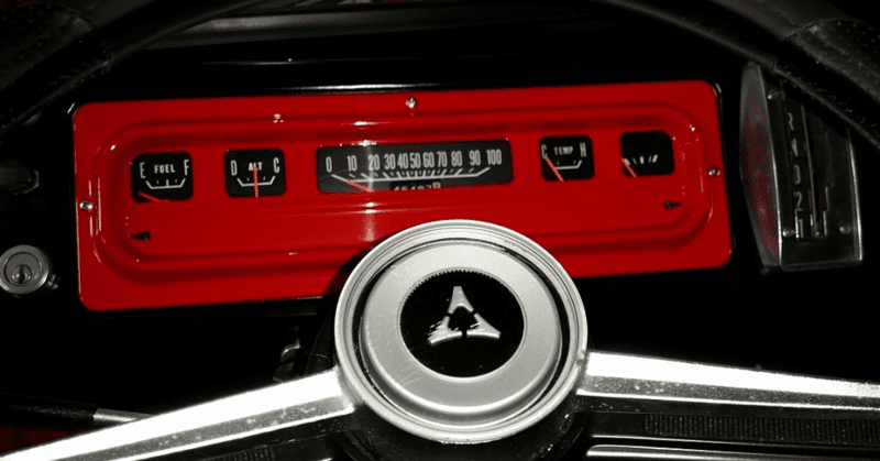

Electrically, the Oil Pressure and Temperature gauges are identical.
I have used an Temperature gauge from an Aussie Valiant as a Oil gauge in my A100. :thumbsup:
Only thing missing is the lettering.
EDITED: Use to have only the Idiot light for Oil Pressure....not much use really....by the time that light comes on, the damage is done.

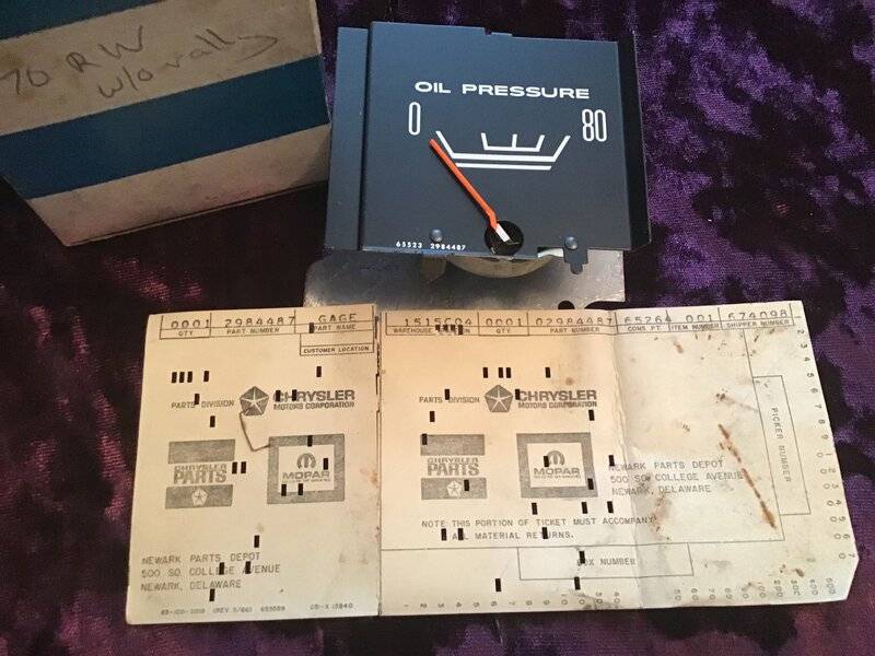

This gauge is for a 70 Belvedere that replaces the idiot light. I believe it was available on fleet vehicles but not 100% sure just yet. My research and play time is short right now.:BangHead:

Thanks guys I got to taking this thing apart yet again another lieing seller!
"It worked great when I pulled it a week ago"
Well there all rusted and haven't worked in atleast 20 years ! The speedo doesn't even rest at 0 anymore!
So junk waste of money not worth buying the replacement gauges!
