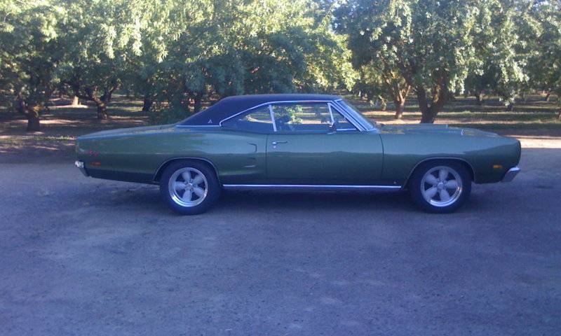

Did 295/50/15 BFG on a 15x10 (5.5 BS) Wheel Vintiques series 63 steel wheel on a 69 Coronet Super Bee. These beasts seem to have more a little room for big meats than Plymouth Road Runners do. Could just be my perception though.
Okay.... How about a little more rubber...315/45-17 on 17x11 wheels
Those 315s look AMAZING!!! I was happy to see the 295s might be an option. But 315.....oh yeah....if they'll fit, I'll be going with those!!
