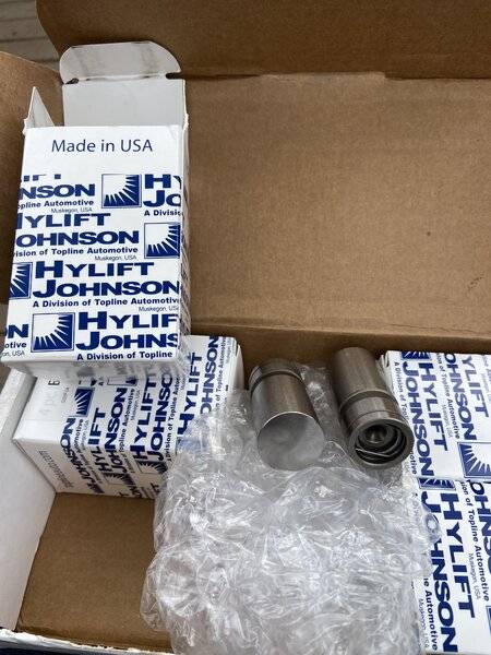

Direct from Top Line Auto Engineering, MI ph. 800-441-1400 ask for Dave ext. 611
Hylift Johnson is located here in Michigan and is a division of Topline Automotive, it's all the same company.
Did you catch Dave's last name ? Is that Dave Popp ??...... is he still at Topline / Hylift Johnson ?
If it is Dave Popp ? and he's still there ?
You will not find a more ethical, stand up NO BS guy left out there at any North American Parts Manufacturers.... you can BUY with confidence !
