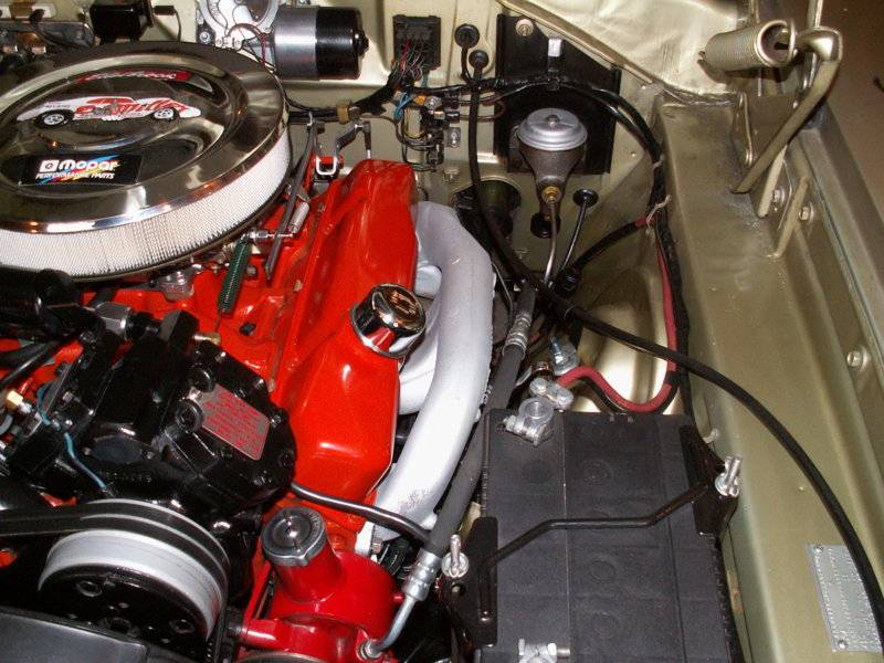

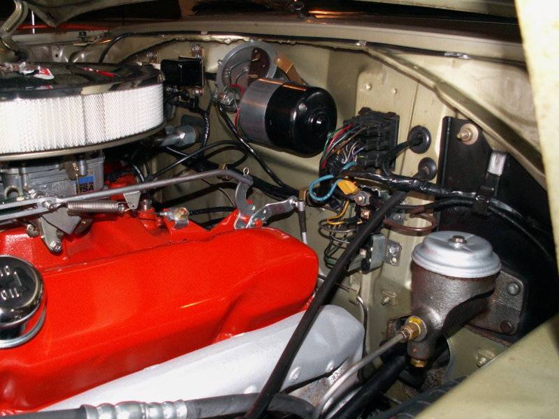

I've got 1968 Hp exhaust manifolds on a 440 -- all in a 66 Charger. No clearance issues at all. Got any pictures of your situation?
Thanks for the photos!!
Long story.... not happy with the motor so I pulled it over the winter. I went with e-street closed chamber heads to bump up the compression. I ran hooker headers with flow master exhaust. The headers would need to be replaced or ceramic coated. I pick up a set of HP's and am really thinking about running them and see how they work. I just wondered if I
They would fit without clearance issues.
