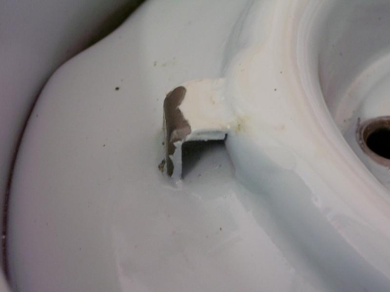

100_0012.jpgi know this works. don't think i'd trust silcone.
on my 65 sat. wheels (police style) had no cap tabs I welded 4 spots on each wheel to hold the cap. tap them on with a rubber hammer see prev. posts painted them and they work and look great. removable and a cheep fix.
