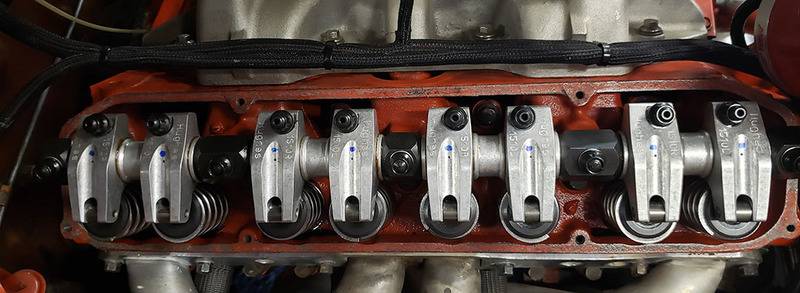

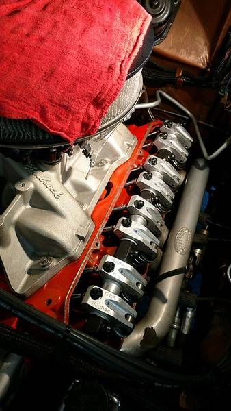

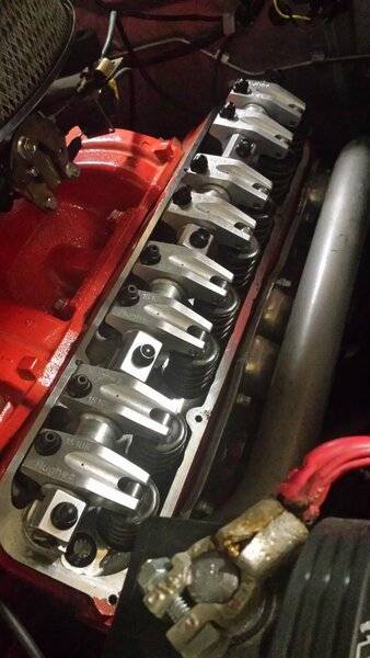

3CCF6ACE-B555-44E0-8D1D-4AA43FFEF6C0.jpeg CF2C2FAC-B82D-4DE6-9D34-8C790BF9BCB9.jpeg
I have the Hughes 1.5's on my 512" with Indy EZ-1's. They seem great. The cam is about .600 with about 250* @ .050 and the geometry looks real good. I'd buy them again, probably 1.6's with this cam though.

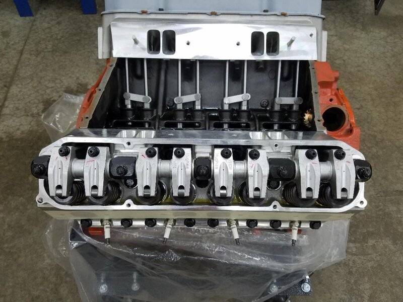

I actually bought the Hughes rockers for my EDE RPM head motor. They worked great on those heads too. The spacer & shim kit is excellent as are his hold downs. So I re-used the set up on my new Indy head 512.
