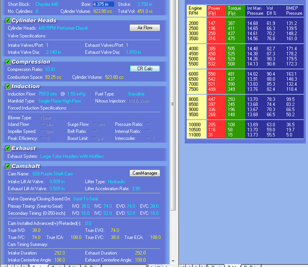

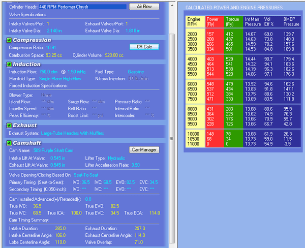

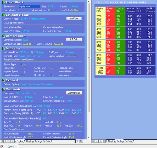

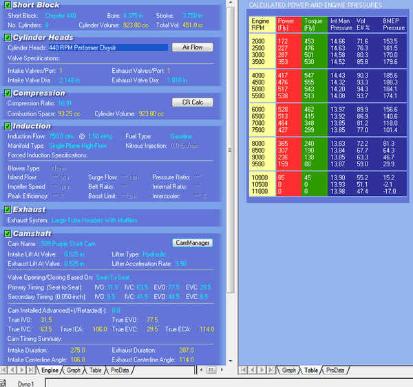

I'll post the screen shot! It was VERY surprising!
Here are the HP numbers at 6,000RPM.. The .509 was a very good performer, with the .545 being the BEST choice if I was to install a new camshaft. The recommendation by Comp Cams was a very good choice. The top choice by cam quest was one of the WORST performers (for PEAK hp). This was very surprising, and I couldn't believe the .509 did as well as it did. Power under the peak was better with the 'newer' profiles, but the .509 really was competitive. The .509 was overall a "good" camshaft. The .545 would be a "great" camshaft. W/ 1.6RR the .509 camshaft made 557HP.
.509/.509 Purple Shaft Camshaft (550HP/Comp Nostalgia .509 Camshaft made -6hp, .484 mopar -25hp)
.545/.545 Competition Camshaft (548HP)
.564/.564 Competition Camshaft (551HP)
.525/.525 Competition Camshaft (528HP)
