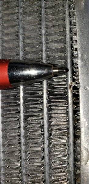

I was on the last hole to drill in the shroud for the fan in the GTO, and I was FINALLY going to be able to button that up and see if it ran w/in normal temperatures. Last hole of a project that we paid someone else to do and more.
Did I mention it was the last hole??
:BangHead::BangHead::BangHead::BangHead::BangHead:
Oh no! That stinks.
I had texted my friend earlier this afternoon that I had finally turned the corner on the "installing the new fan and shroud assembly" project that has been fighting me relentlessly. I thought I had all of the hardware (L brackets, nuts, bolts) I needed, but then I decided to avoid draining the coolant in order to remove the radiator, I would change the bottom brackets to a different type that wouldn't require the removal of the radiator. That led to difficulties in accessing mounting points. I had that all figured out, brackets cut, driver's side lower bracket installed, one of 2 holes in the shroud drilled. Drill the 2nd hole, mount the passenger side lower bracket, 2 top brackets were already setup, wire the new fan into the existing wiring, program the controller and test drive.
NOW I have the coolant drained, and the radiator out anyway. I'm going to call a local radiator shop tomorrow. I went to High School with the owner. If the simple (for them) repair is quick and reasonable, I'll have them do it and mount the fan and shroud assembly's permanent L brackets top and bottom, and install the radiator with the fan and shroud attached. If the shop is outrageous in cost or time to get it done, I have some flux and solder and I may just fix it myself.
