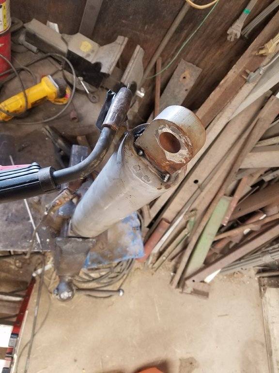

I frequently must make repairs to my equipment. Most of them would be of interest to the mechanics here. This is one I made yesterday. A large hydraulic cylinder on my Hagie agricultural sprayer broke an ear. Here are a few pictures of the repair process.

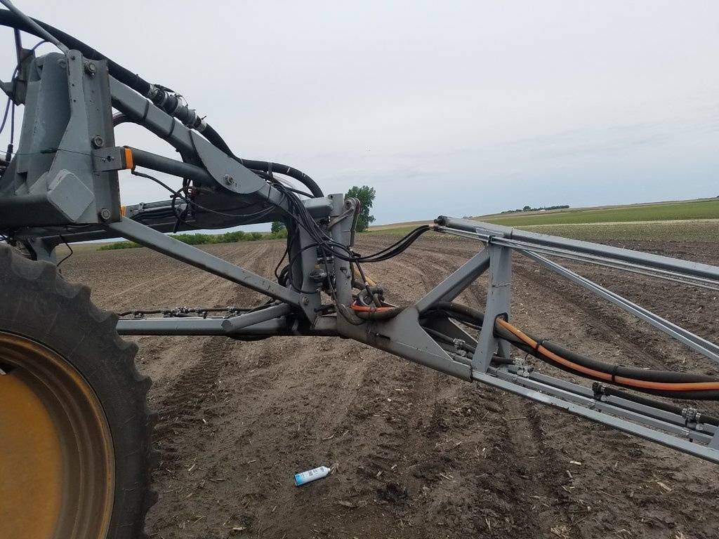

You can see where the cylinder was after removal. The far end of the boom is resting in the ground. Luckily the operator was only creeping along when this happened otherwise it would have been a catastrophe.

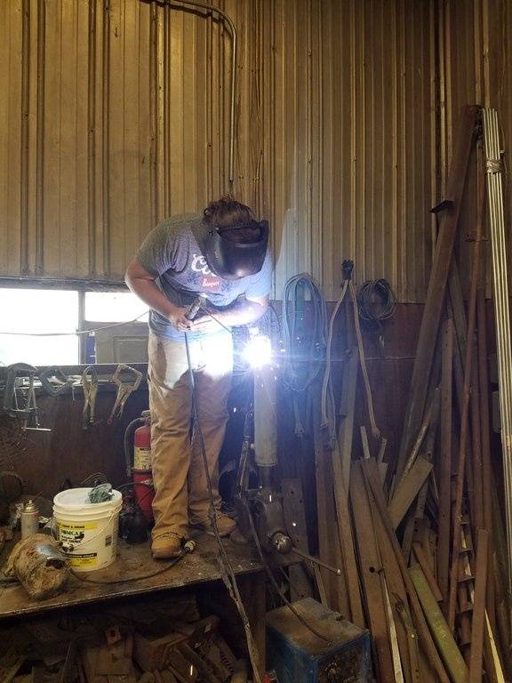

After marking the proper direction and placement I used an angle grinder and ground the original welds down. Exact placement is imperative the ear must be perfectly placed back to its original position. So it must be placed in a vice so that it's a flat weld and not a vertical. This means that I must work off a ladder. I use my 110 Lincoln wire welder to tack weld the ear into place. Then I brush the surface off and get the Miller arc welder with 7014 rod. This needs to be a multi pass job and 6011 isn't my rid of choice for thus application I retail it in a few locations. This time with the stick welder. Double check for straighteners and clean it up again.

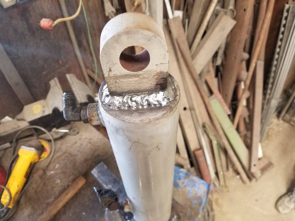

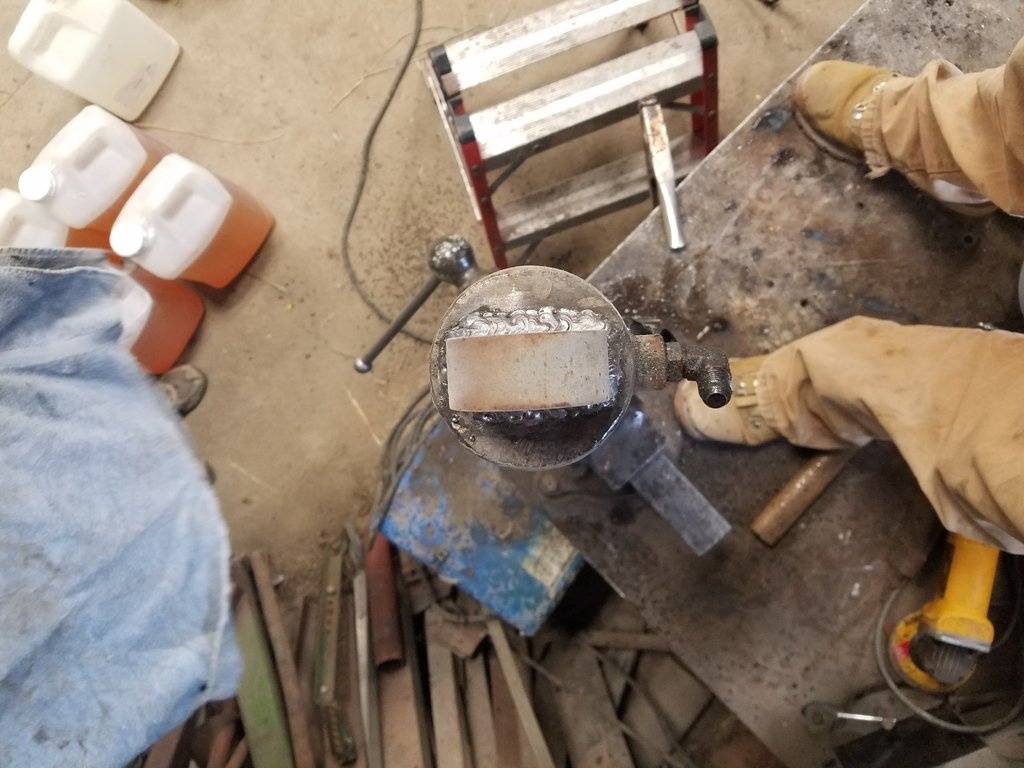

I weld it one side at a time. Then clean it up good and repeat and repeat.
After 2 layers I'm satisfied with the results.
The sprayer was reassembled. During reassy I noticed that this broken cylinder was merely a symptom of other problems.
There are some spots on the sprayer boom that need welding and pins (1.25" diameter) that need repacing. Do the job is really just getting started.......
You can see where the cylinder was after removal. The far end of the boom is resting in the ground. Luckily the operator was only creeping along when this happened otherwise it would have been a catastrophe.View attachment 428577
After marking the proper direction and placement I used an angle grinder and ground the original welds down. Exact placement is imperative the ear must be perfectly placed back to its original position. So it must be placed in a vice so that it's a flat weld and not a vertical. This means that I must work off a ladder. I use my 110 Lincoln wire welder to tack weld the ear into place. Then I brush the surface off and get the Miller arc welder with 7014 rod. This needs to be a multi pass job and 6011 isn't my rid of choice for thus application I retail it in a few locations. This time with the stick welder. Double check for straighteners and clean it up again.View attachment 428579I weld it one side at a time. Then clean it up good and repeat and repeat.
View attachment 428580 View attachment 428581

That boom is going to need all hoses, (product and hydraulic),fittings and valves replaced as well as some welding. These things are high maintenece to say the least.
