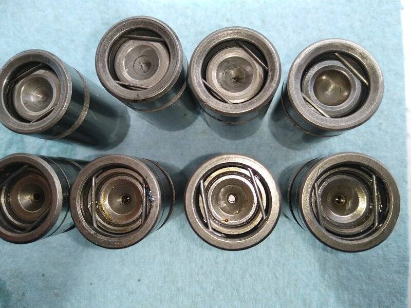

Today installed a new flat tappet into a 383 from a Mopar oriented shop. I noticed 4 of the 16 the plunger look different. They also pumped up just cleaning them with brake cleaner. No holes vs holes in the plunger. What is the difference. All from the same set.
You sure those four aren't solids? Kinda looks like it... I'd be looking further & making a phone call....
Don't look like a matched set of lifters to me! Looks like those 4 missed part of the machining process. 440'
I'm guessing missing operation as well. They do have retainers and they did move when dry.
Lifters that are “correct” for a BB will not have holes for pushrod oiling.
Old stock for a SB may be the same as well, but many cam grinders and parts suppliers sell what I refer to as the “universal” lifter...... like a Sealed Power HL-2011, which can be used in SB, BB, and AMC applications, and they have the pushrod oiling holes.
The pushrod oil feed hole is only necessary if you’re pushrod oiling.
I would choose the lifter without the unnecessary holes.
I try and use the “correct” lifters in BB applications(high narrow oil band, no pushrod oiling), but I’m not sure that’s an option for a SB.
The SB has the lower, wider oil band....... and any lifters I’ve seen in the last 25 years or so with that oil band has had the pushrod oiling.
Edit: looks like the Mopar lifters for a SB, P3614321, came without pushrod oiling holes....... at least that’s how it appeared to be in the 2001 catalog.

take the tappets with the holes apart and see if there's a disc under the push rod cup; bet there is. i'd be more concerned about what looks like 3/8" ball cups vs 5/16" cups. i wouldn't use mis-matched cups.
Boy, Id like to get my hands on some machines to make them.
Good eye. Just appropriately mis-match the pushrods too.
i've taken a bunch of tappets apart before and pretty sure that little metal disc prevents the push oiling. take the disc out and then you have AMC tappets,...?? direct connection years ago had some hydraulic tappets with 3/8" cups, but haven't seen that in years. the concern i would have is a preload difference between the two with stamped steel rockers. the stuff can be mocked up and checked with a checking push rod to see if there's any major differences.
The metering disc is usually there to......well.....”meter”..... the oil going to the top end with pushrod oiling.
If the pushrod cup has no oil hole, there’s no need for the disc.
Different brands of lifters untilize different types of metering discs to do that job.
