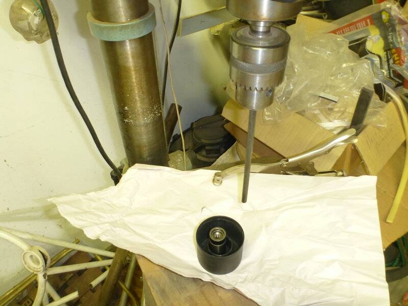

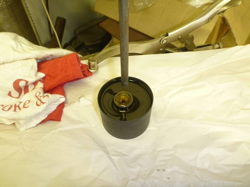

        Just make sure you grab a paint can lid WITHOUT a vent hole in it....
