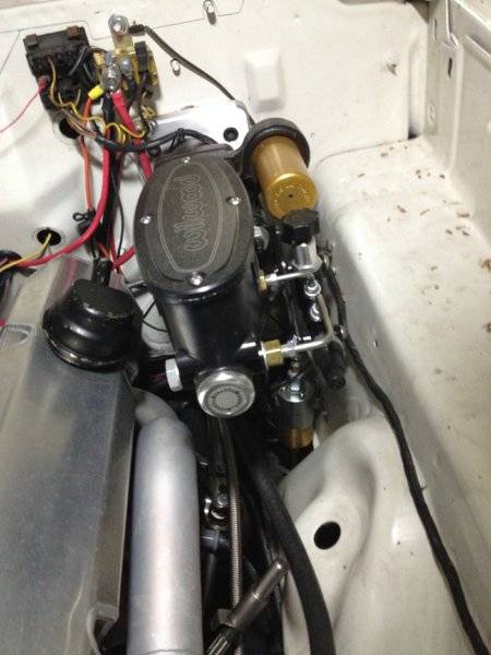

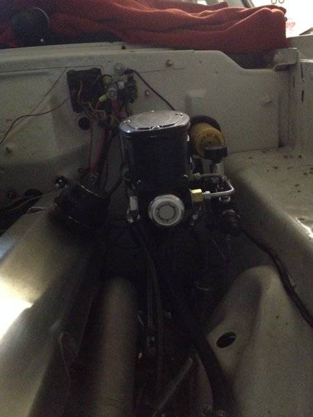

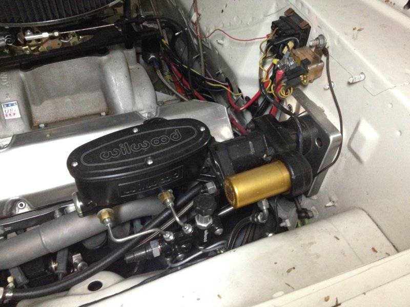

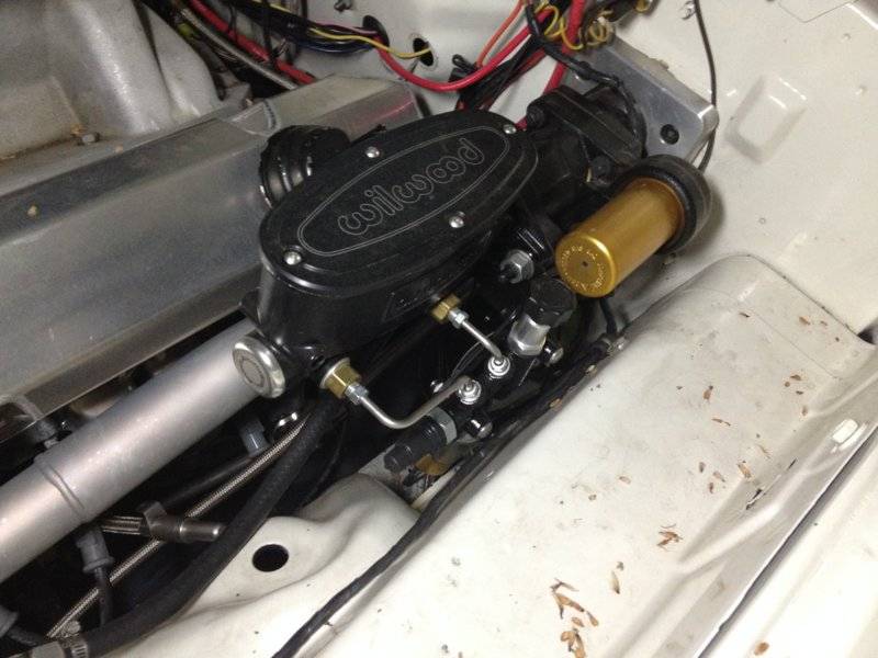

Absolutely love mine, the best setup for any street car, the brake's feel like a modern car super responsive, I did the whole wildwood set up, hands down one of the best up grades I made to the car!!

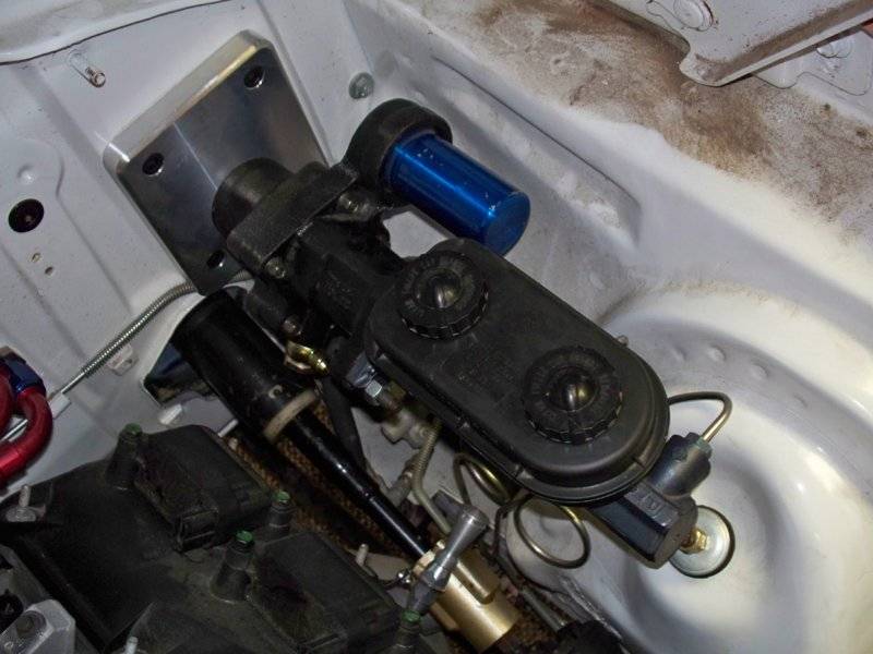

I made my own "kit" for my 68 Charger - Ramcharger master cylinder, rebuilt asto van hydroboost, fittings, pressure lines, and all that - mounting plate was from Talon hydraulics -- whole set up cost me about $250

The Astro Van Hydroboost was out of a 1990-1995 Van - mine specifically was a 1992.
Master Cylinder was a 1992 Dodge Ramcharger unit (slight filings to mounting holes was needed to slightly alter bolt pattern)
Talon hydraulics had the plate - I asked for one without their logo and they now sell them that was IIRC
Used correct fittings to -6AN for feed (IIRC -6AN to 1/2-20) banjo

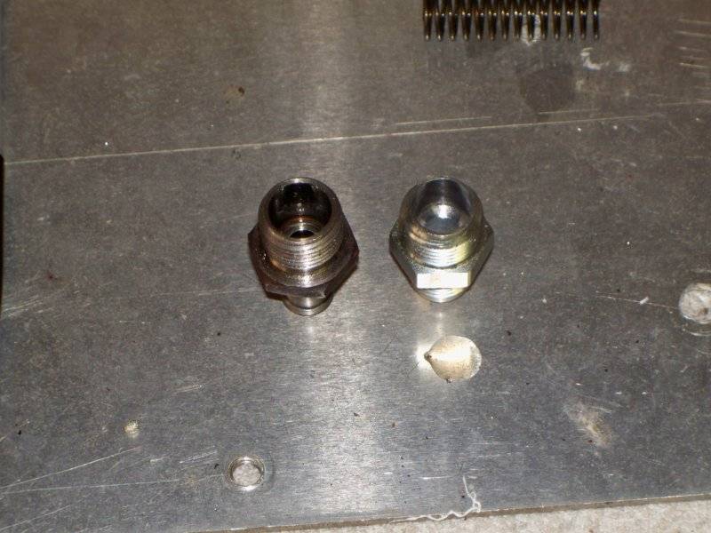

Biggest thing that required "work" was making the AN fitting for the return -- I believe it was -6AN to 11/16"-18 --- this fitting needs to be drilled out for the check ball and spring to seat correctly. I measured the depth of the factory box fitting and drilled the new fitting to the same depth
The factory Power brake lines from inline tube basically fell into place and worked with this set up as well.
The pushrod was replaced with a threaded stud and just used an adjustable clevis for the linkage rod to attach to the brake pedal
I believe all this was correct but keep in mind I did this back in 2009 so my mind is a bit hazy - double check fittings sizes before ordering!

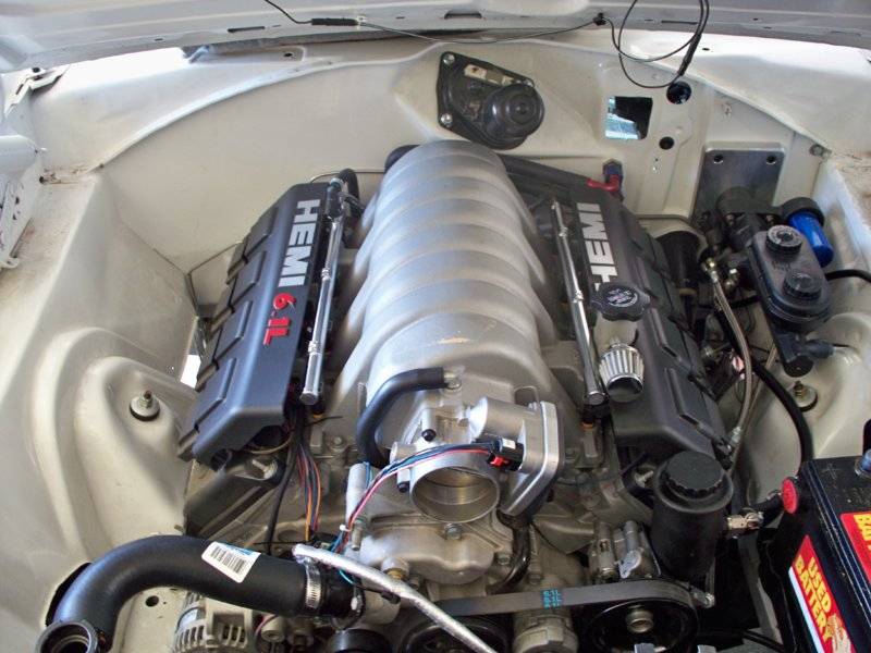

I also made my own
Used a 2010 ram 3500 system.
EVERY diesel truck has one. Just have to reclock and maybe change up pushrod.
