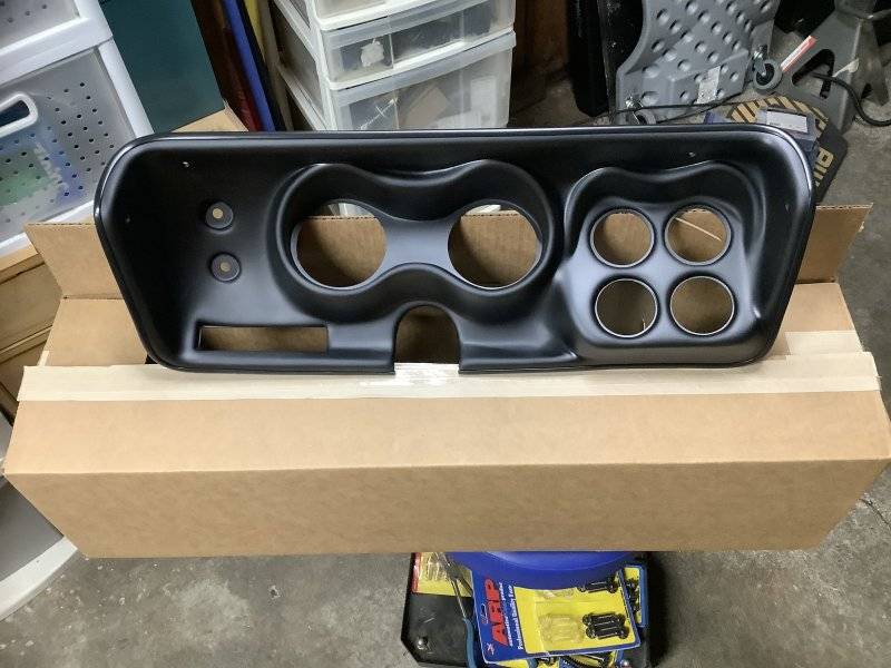

Currently I have the gauges removed and as weather permits I am installing the dash insert with Autometer gauges which means another harness to blend in with the original dash wiring. I have never liked wiring and this car has been a fantastic teaching tool.

Sucks big time. Took me all winter to rewire my entire car! Worked on it on a Monday and or Tuesday then took rest of the week getting a game plan for next time. Looking at both schematics, the original and the new that came with Ron Francis kit! Go slow and one system at a time. You’ll get it!
This is what I started with!
